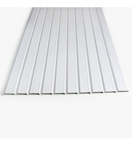

  2. Arch Panel Waves: Another great tool. I ask myself if the wave types will grow with the time (A rectangular type would be very usefull)

I have never seen such a profile.. Any example?

Aha, great. That would be easy to add. We need a third value besides wave length and height, the spacing between each…
