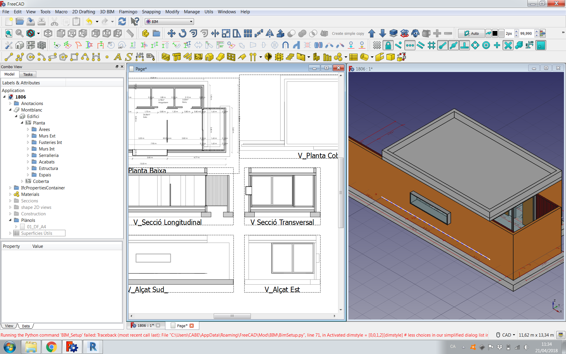

I also have found an error while I click the “Set some common FreeCAD preferences for BIM workflow” button. I attach a screenshot
Thanks for all your time and work!
should be fixed now!
