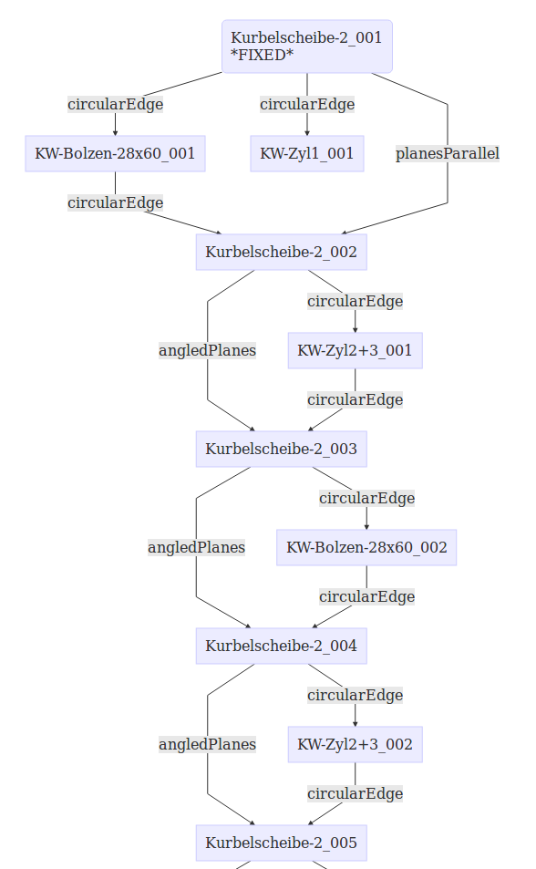

I know, but from your flowchart I couldn’t recognize the flow that gets to conclusion that all the objects should be added alltogether…
TADA!!!
That’s the hierarchy that the algorithm creates from all the rigids and constraints.
Good parts naming will definitely help with those charts…
Those charts are created semi-automatically, have to copy&paste some text to an online tool.
If I will find a way to create a file from within the python, I could create HTML directly from the code.
The addition is based on the code I proposed, so if it will get into main, I’ll PR those additions too.
If we’ll have the dependencies DOF analysis based of Turro’s work, it can easily be added to the charts as well.

Great charts, generated by your algorithm @project4. This is a big improvement.
I will create some very ugly assemblies for testing, directly done with A2plus (“all together mode”). As Assembly 2 could not solve such complicated things. It also could not solve the 6DOF example. Therefore Assembly 2 test files i think would not be difficult enough.

I need to ask: For your great(!!!) charts, do you extract the object labels or object names of the parts? Sorry for my humble german part namings and even weird abbreviations. I’ve never thought on part and assembly creation that it may help for this project somehow.
For my re-assembled crankshaft in https://forum.freecadweb.org/viewtopic.php?f=20&t=29207&start=260#p245241 (fcstd file: https://forum.freecadweb.org/download/file.php?id=63542) I’ve only changed the labels conforming to @Turro75’s original A to O part naming from his diagrams, like @kbwbe pointed out last evening. So, can be that my changes are useless for you.

Now the 6DOF hierarchy is more accurate to the assembly relations:
Hi,
Yes, I’ve changed the code to use labels instead of objectName and here’s the chart for the file you sent.
I think we better add the DOF analysis to the code, so we could have the automated charts out of the file to see how the algorithm sees them, that will probably save a lot of manual work.
I can add any known info to the chart. Since lock rotation is not handled, as kbwbe wrote, I think there is no point to print it at that time.

brilliant job!
Thanks!
I’ve update the code to create “assembly_hierarchy.html” file in home directory.

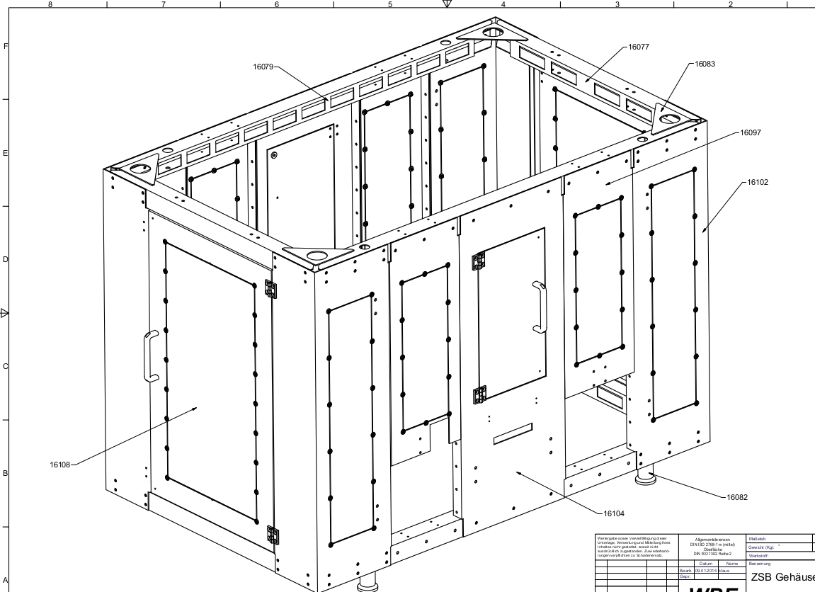

Just detected another big problem within basic solver algorithm.
I tried to assemble the first “real world” project. A machinery frame with some bigger dimensions. Some parts are about 2 meters long.
This assembly i want to use as one more standard test. This assembly can be extended with other connected frames.
I cannot assemble it. All solver variants fail during 2’nd constraint. Sure a problem with basic algorithm. Something seems to depend heavily on size of parts.
I attach the parts which i try to assemble within a ZIP. (including the failing assembly with two parts)
Whole Frame looks like something as this when ready…
I will have to check all mathematics !!!
