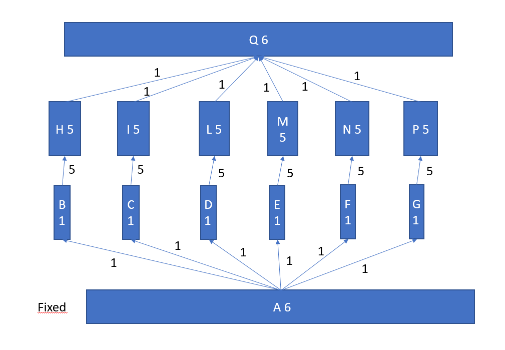

I reworked the 6dof assembly charts:
I’m thinking that spherical weigth 3 only if the coincidence is in the center of the rigid. hopefully we won’t need a so deep analisys :confused:

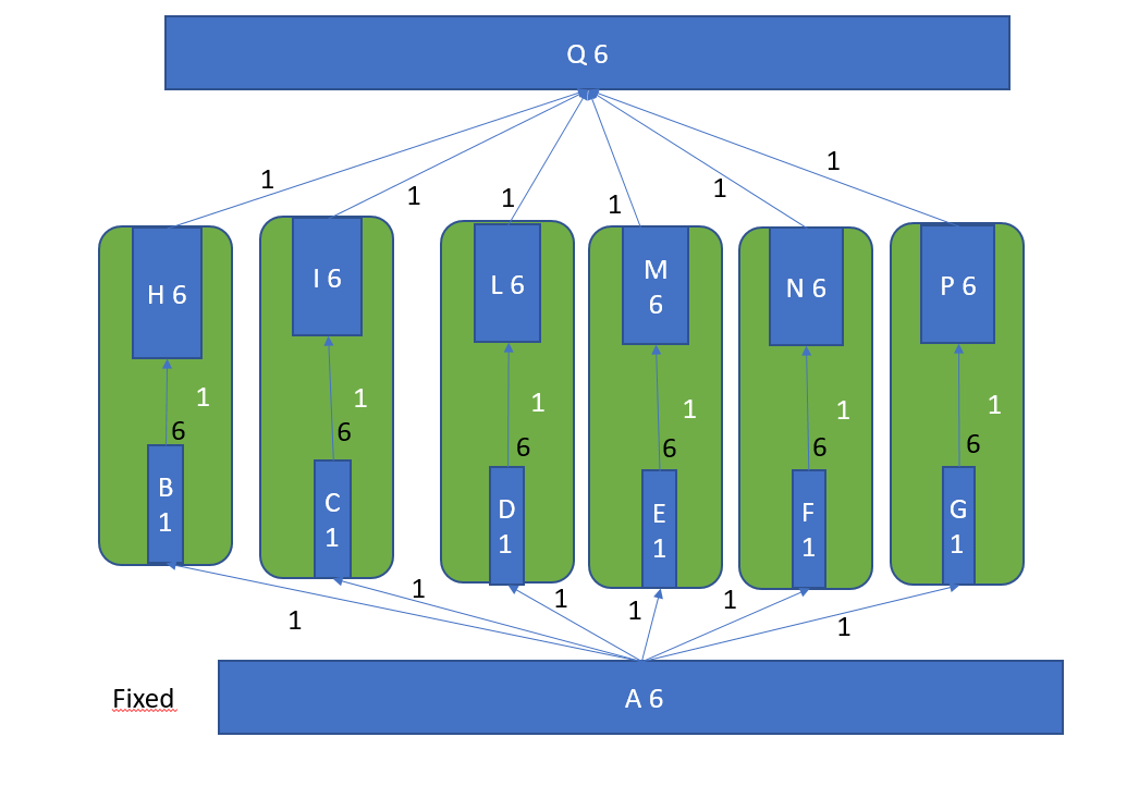

look what happens if rotation is locked, in this case we can individually solve each pair piston+cylinder, fuse them in a single rigid which has a number equal to the sum of the constraints of the fathers.

Last diagram with lock rotation is not quite correct in my opinion. Each cylinder connected to platform needs 2 angles to move. Weight seems not to be correct. Same for pistons..

this is my proposal for reduction to subassemblies and solving process
it would make sense in case of solve failure switch to current “all together” solver.
I’m not sure rigid replacement and fuse is really necessary in the first and second steps, for sure the third step need it.
let me know how about

Few questions for now to understand what you wrote:
what do you mean by “check if any obj which has a father fixed it isn’t in the whole list of father” - can’t understand the last part of the sentence.
don’t understand what objects are selected for the first stage calculation.
All fathers are fixed - ok.
it is no father itself - you mean it’s a final leaf in the tree and there are no children for that object?
Maybe I didn’t fully understood the logic, but selecting only objects that have all fathers fixed doesn’t work. See 6DOF assembly, the cylinders are connected to base1 (fixed) and don’t have other fathers, but they can’t be calculated by their own…

If an object has no sons so nothing depends on it and if the same obj has all fathers fixed . Solve it immediately and forget it. It won’t hurt anything.
Take the chart crankshaft, the obj A is exactly this an object which can be solved even if not fully constrained.
in The 6dofassembly in fact you can’t do nothing, only third step (pistons and cylinders pairs joined as a single rigid if lock rotation active) and the last with all remaining together.
Still on 6dof, without lock rotation You can only do the 4th step (as it should be imho). So the solver has to handle 14 objs and 18 constraints
With lock rotation on we can do something on step 3 and reduce the 4th step to 8 objs and 12 constraints.
