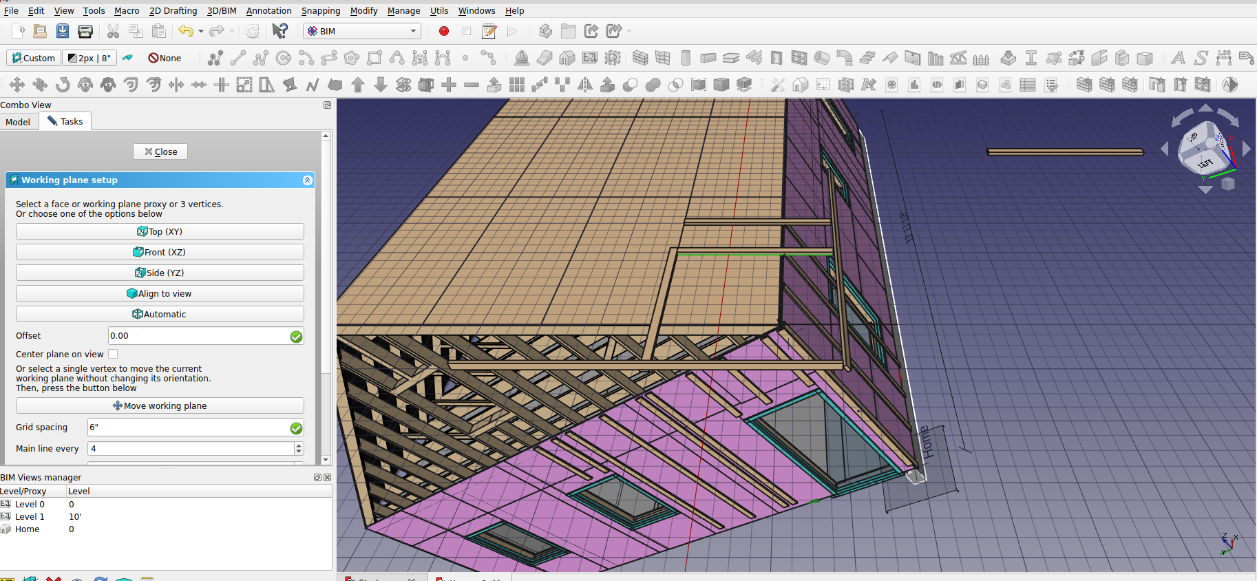

Right now I’m trying to work on some details on the roof surface.
Instead of looking at the front, left, right, or top of the roof, I need to look squarely at the surface of the roof. So that up the roof is Y, towards the ends is X, and directly through the roof is Z.
I don’t know what this is called, or how to do it…
Ah, I think I figured it out…
To change the working plane and view to the face of an object:
  1. Go to the Draft workbench.
  2. In the Utilities menu, pick “Select Plane”.
  3. Click “Move working plane” and pick the face of the object you want to move the working plane to.
    Now the X/Y/Z are aligned with that object and if you pick “center view” your view will be rotated in line with it too.
