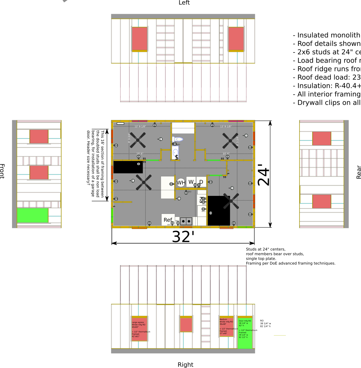

I’m building (well, only planning at this point, obviously) an energy and materials efficient, simple, small home for my family of 4, which meets my local building codes, and can be converted to a garage in the future when we build a larger home. It’s my intention for this to be contributed as “open source” when I’m done.
I had originally done the floor plan, framing plan, and elevations in Inkscape, but keeping the various views up to date meant edits in multiple dimensions from multiple views and damn… it was a hassle.
I’m hoping to build this in Freecad to make my job easier, but also to learn more about Freecad and the right way to use it for architectural / structural drawings.
Unfortunately I’ve drawn this thing probably 15 times, always finding an impassable limitation to how I had been doing it that convinced me my technique was wrong in prior iterations. So here we are now.

FreeCad seems well suited to generically do walls, but not the actual framing/structural details inside those walls. I’m trying to make sure that the structural details are available. Additionally, I’ll need to provide cross sections and drawings that show flashing details etc. The workflows are quite different I think.
Here’s a PNG of what I had done in Inkscape. You can imagine why it was such a pain to keep up with… Also I’ve had to make the whole thing somewhat larger, and noticed some mistakes in my stud layout. So this is very much obsolete.
When I first started doing the overhang and truss design (Trusses designed by a third party) I had to do that in FreeCad since Inkscape couldn’t handle the angles. While what I did looked right… and the truss design was a totally parametric, fully constrained sketch… None of the other pieces are constrained to each other. So now that I need to make this 2 feet wider, I have to redo so, so much!

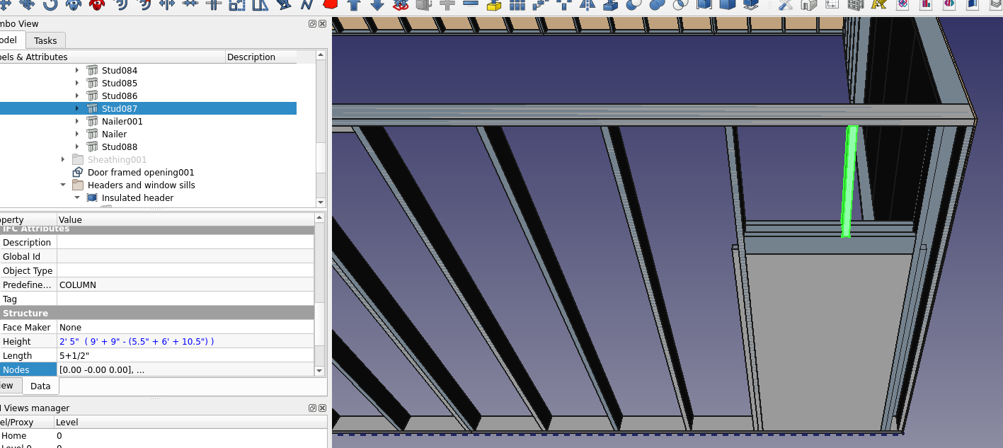

So now I’ve got a stud that I need to be shorter. It needs to hit the top of the header, obviously. I could do some math in the data dialog… which is what I did. The stud needs to be (stud length - (door opening height + header thickness)). And then it needs to be moved up.
While that works, the numbers entered aren’t really tied to anything else which is silly. And it’s hard for the drafter. It would be a lot easier to “constrain” it by saying “This stud needs to be long enough to span between these two members”.
I’ve also done this with formulas using the .height etc parameters… but the difficulty in building those queries kills me, especially the fact that you have to use the internal names of the objects and not the names you’ve given them, and there’s not a great way to build that info.

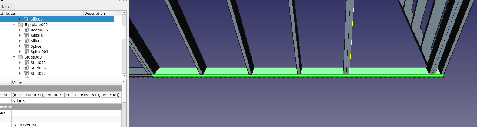

And I just realized I didn’t cut the sill plate like I should have. So I have to go in and manually tweak these things again.
This is usually the best way of keeping things parametric. You can use the Object’s label, you just need to enclose it in brackets, <>.Height.
And of course, you can use a spreadsheet to collect all such variables.
This is further explained in Expressions. The Spreadsheet Workbench is essentially an interface on top of the expression engine.

Nice to know that I can use <<>> for the friendly names. It’s definitely still a pain in the butt to do <<Door framed opening001>>.Height + <<Sill002>>.Width + <<Beam043>>.Height / 2.
  • Is there an addon that adds more robustness to the formula authoring, like maybe the ability to click an object, or a larger dialog for building formulas?
  • How can I reference the X position of something? I can do .Placement but it appears to be a dictionary with Pos and Yaw etc, and I can’t do .Placement.Pos.X.
  • Is there any way to reference “the minimum Y” of an object? Some things are placed by their centers, but often I just want to say basically “From the bottom of”.

Oof. Frustrated that I can’t easily shorten this sill plate to end at the highlighted stud. Scale won’t work. I instead measured the distance with the dimensioning tool and then subtracted that from its existing length.

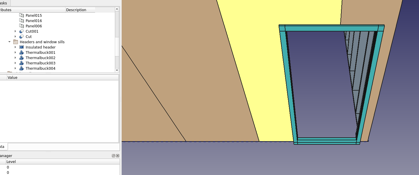

I used the Difference tool (In BIM workbench) and an extrusion of my doorway dimensions to cut the two panels that needed to be cut for this door. Threw the profiles of the 1" Thermalbuck in and extruded those, placed them properly on the surface of the sheathing. Couldn’t figure out a good way to bevel cut the ends at 45 degrees that would still allow me to scale if I have to make tweaks later. Also lowered the door opening to the floor like it should have been.
My window openings on this wall will be the same height as the door. Is there a parametric way to place headers at the same height as the door headers?
