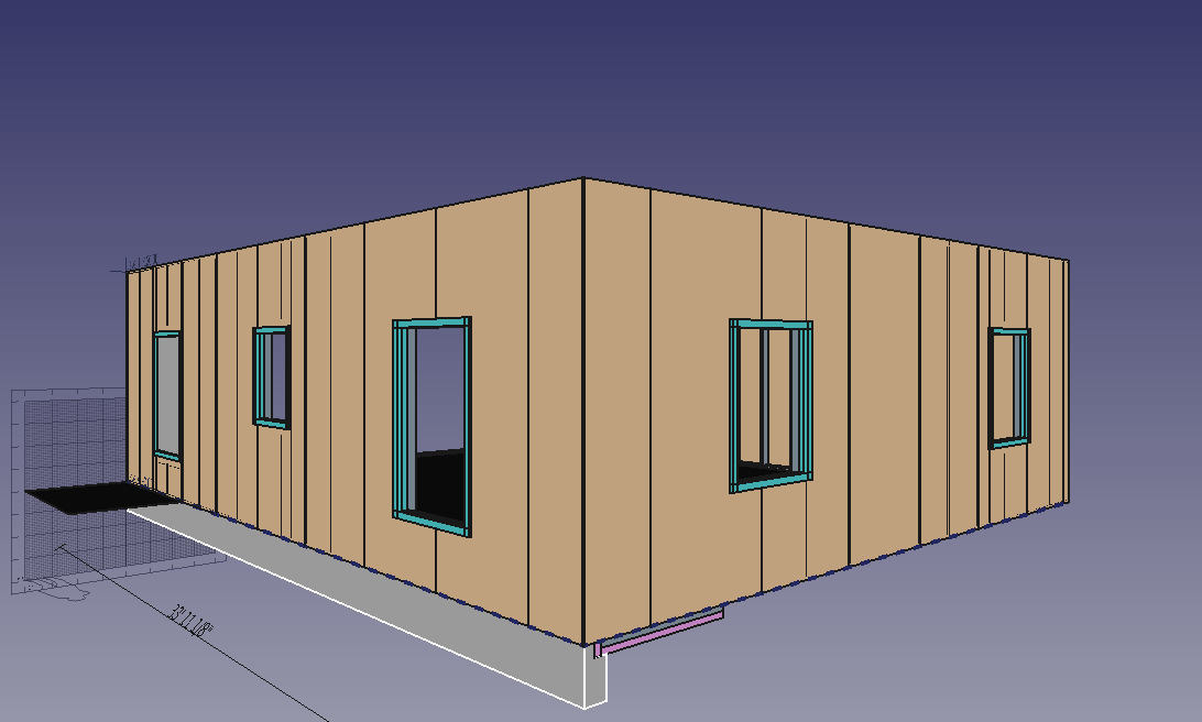

I finished the structural parts of the “front” of the house. I am not super enamored with that entry door (which isn’t the main entry door) location aesthetically… but don’t really have the room to move it further inboard. The perils of a small home design…
I also did my first section view. I wonder if there’s a way to make it only show the objects that pass through the section?
But the wife decided she was fine not having a door in the bedroom at all, which saves money… so I just made the window that I forgot to put in there bigger.

  • Any videos out there that show a good way to do a truss assembly? I’ve done a whole truss in the sketcher which is awesome but isn’t extrudeable to dimensional lumber because, well, it’s multiple solid pieces. When you use the option in sketcher to copy external geometry, does it auto update as the external geometry moves around? I’m assuming not.
Hi Overkill, your design is progressing fast. Looks good.
With the Section you can resize the section area and change the position to cover the area you are only interested in seeing in the section. Once sized/positioned, turn Section Plane Clip to True. Instead of a Fit All type section planar area, now you’ll have clipped section planar area only showing what you want to see.
Recompute the Section and the TechDraw Page to force the clipping changes through to the TechDraw drawing. Sometimes TechDraw pages won’t update properly.
Note the changing the Section to clipped may make your TechDraw drawing page slow to initially properly redraw the clipped section.
Also as general note, whilst making any large changes to your 3D model (the main drawing) turn the TechDraw page Keep Updated to False. You’ll speed up your 3D Model alterations as the file gets bigger. This disconnects automated updates of the ever-changing 3D Model info into the TechDraw page till you want to update the TD Page. I can almost guarantee you’ll forget to turn the Keep Update back on to True, wondering why your drawing fails to update!

Yeah, I think that’s what I’ll do for the trusses. Been a wild few weeks, fired up the latest Freecad 0.19 rev 22366… open up where I left off doing the door previously… and then…
Oof. I can’t select the sheathing panel that I need to cut out the door opening in. It just goes to selecting Default Site when I click it in the view. Strange things ensue…
https://cloud.schwend.us/index.php/s/9ccoJXsYtPB5PK7/download
Basically I can’t seem to interact properly with sheathing panel Panel010. So I can’t cut the door opening. Hrmph. I guess this is why I put it down so many weeks ago.
I have seen this before. The problem is caused by the default site containing a 3D representation of the nested objects. The solution is to delete the site (without deleting its content of course). Alternatively you can change the Selectable property (on the View tab) of the site to false.
Toggling selectability off made it so the site no longer got selected, but I still couldn’t select the panel from the 3d view. Your site-deletion suggestion worked, however.
I’m still unable to use the Subtract tool with an extrusion and a panel… No errors or anything in the report view. I thought this was how I did the holes previously…
You have used the Part_Cut tool. The Arch_Remove tool does not work with panels.
That Selectable property on an Arch Site has proved to be a nasty gotcha! I too got some odd selection results after it it was toggled to False but deletion fixed the issue.
I beg to differ - that’s how I do it all the time - see attached file.
Draw Panel, re-orient upright and re-position to suit. Draw rectangle partially covering panel, extrude it to straddle panel. Select extrusion, Ctrl-select Panel, press Arch Remove. Voila, a cut panel!

You are correct. The question is then: why does it fail for Panel010 in OverkillTASF’s file?

I see in the latest gitlab version of the house from OKill, there is no cut of Panel010. Looked at previous copies I had downloaded, I’ll admit that I did lose track of which copy is which. Maybe some sort of versioning is required in the filename?
The underlying rectangle for the extrusion seems to be at 90 degrees to the actual Panel010 and is located at the rear of the house/garage we should be cutting something out of. Once re-oriented by 90 deg to be aligned to the panel, re-positioned the rectangle to the intended doorway and then reverse rotated / repositioned the extrusion by 90 degrees an actual cut seems to work on Panel010 using an extrusion and Arch Remove.
Cheers, PMac.
Thanks for your analysis. But this may also be a bug. In the original file the extrusion and the panel intersect. I would think that the Arc_Remove command should then work.
