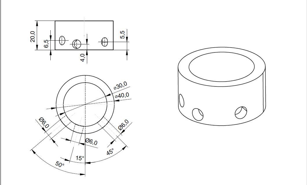

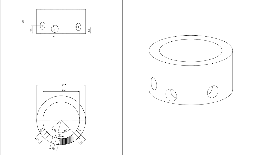

Here is the correct technical drawing, attached the FC file revised in the layout.
As you can see, the two technical drawings, one made with another cad3D, have similarities, but the one made with an alternative cad has some peculiarities (more technical) that TechDraw cannot yet do, moreover the speed of execution of the technical drawing with TechDraw has been more slow.
In order to have these peculiarities and be faster it should be integrated with the tools that are specified in this post https://forum.freecadweb.org/viewtopic.php?f=35&t=49719&start=30
dimension-hole_3.FCStd (60.1 KB)

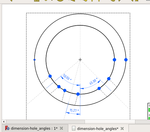

Liberal application of center lines will help.
Also I’m confused about the dots displayed for the holes. I expect four (or six) dots to represent the holes. The right hole has only two dots, the middle hole has way too many. Maybe I’m doing something wrong here.
It isn’t you. It is a problem in OCC. Use the perspective projector with a long focus length. It will often produce a better projection that the orthogonal projector.
dimension-hole_angles.FCStd (215 KB)
Sort-of. What I’ve tried:
  • Horiz Center Line: True
  • Vert Center Line: True
  • Perspective: True
  • Focus: 1km
That results in sane snapping points and centre lines. Then I tried adding centre lines for the holes like that:
  • Select the two snapping points for a hole
  • “Add centerline between two points”
  • Aligned: ✓
  • Extended By: 25mm
  • Colour: #7f7f7f
Centre line appears. So far so good.
But it’s not possible to create an angle dimension between the vertical centre line and the newly created hole centre lines. Why? The function “Insert Angle Dimension” does not snap to the vertical centre line. It can’t be selected.
However, if I create another vertical centre line manually it works, though. But then I don’t understand the idea behind the vertical/horizontal centre line option. And manually creating centre lines if TD has a dedicated centre line option feels like a workaround.
So to conclude my problems why I failed to create the drawings: The snapping point bug + the inability to add dimensions to centre lines (which there might be a solution for).

12 - I don’t quite understand. You write “since this hole has no references on the inner circumference”. But it does: the hole has two vertices, snap points on the inner circumference. The references on the outer circumference however are missing. Either I’m misunderstanding you or maybe it was just a typo (inner/outer).
New Cosmetic Vertex → Point Picker doesn’t allow to snap to the correct position. It’s only possible to select some random point with no relation to the part. I instead used the inner snap points, resulting in straight lines (from the dimension) rather than dotted lines. Alternatively one could maybe display the hidden lines (also more of a workaround).
I was not able to solve this.
14 - Maybe this is related to the bug, I’m working with wandererfan’s workaround using “Perspective: True” and then there are only snap points on the inner circumference. So I see no way to (precisely) place those points.
15 - TD displays an angle of 130° rather than 50° no matter what I try. This is not incorrect, but not what I’m after. Maybe I’m doing something wrong here.
Thank you again for the detailed description. Frankly, that’s quite a convoluted process as you have already indicated, even for a very simple drawing as this one. And in the end I couldn’t get it exactly the way I wanted (as indicated above). It’s a mixture of i) bugs in FC/TD/OOC and ii) my inability to use the program correctly, I presume.
If you (or someone else) has solution for the issues I wasn’t able to solve, suggestions/solutions are welcome. Steps I couldn’t solve:
