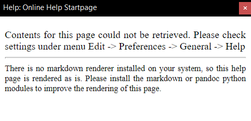

[win conda] FC can't find doc renderer
docs installed via addon manager :: Installation location: C:\Users~\AppData\Roaming\FreeCAD\Mod\offline-documentation
FC been restarted.
C:\Users\~\Documents\FreeCAD_weekly-builds-30694-2022-10-20-conda-Windows-x86_64-py310\bin>pip install markdown
Requirement already satisfied: markdown in c:\users~\anaconda3\lib\site-packages (3.3.4)
C:\Users\~\Documents\FreeCAD_weekly-builds-30694-2022-10-20-conda-Windows-x86_64-py310\bin>pip install pandoc
Requirement already satisfied: pandoc in c:\users~\anaconda3\lib\site-packages (2.3)
Requirement already satisfied: plumbum in c:\users~\anaconda3\lib\site-packages (from pandoc) (1.8.0)
Requirement already satisfied: ply in c:\users~\anaconda3\lib\site-packages (from pandoc) (3.11)
Requirement already satisfied: pywin32 in c:\users~\anaconda3\lib\site-packages (from plumbum->pandoc) (302)
Despite this:
Please install the markdown or pandoc python modules to improve the rendering of this page. :question:
that’s probably not the right way of installing them, those listed in the message are likely not available to freecad
Not sure what to do with that information. Not a python buff. Any ideas?

according to https://github.com/realthunder/FreeCAD_assembly3#installation
the correct way is to open cmd in your FreeCAD installation bin directory and execute
python.exe -m pip install *insert-package-name*
