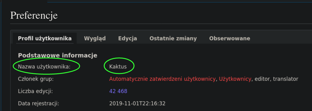

which user are you using? kaktus has normal editor permission, but kaktus_pl not, i don’t know the reason…
My Wiki username is: Kaktus

Aah i see, only admins are able to create pages in the MediaWiki: namespace.
I don’t think this restriction is very important to us.. i’ll look at how to change that
right, that was the purpose of my previous feedback. that’s great if you can modify the rights.
Ok enabling all users to modify the MediaWiki namespace seemed dangerous (you could break the whole wiki), so I did the following: From now on, members of the “admin” group will be able to modify/create pages in the MediaWiki namespace. (admins are not not wiki administrators, the “admin” group was created by the Translation plugin and gives additional powers related to translation, for ex. delete or move translations, etc)
So basically, who wants to edit MediaWiki: pages, please ask me (here or via PM, tell me which wiki username) and I’ll upgrade your wiki account.

Done! Can you check if it works, if you are able to create a page in the MediaWiki: namespace?
:mrgreen:
Thank you very much for all your time :exclamation:
Works perfectly :bulb:
