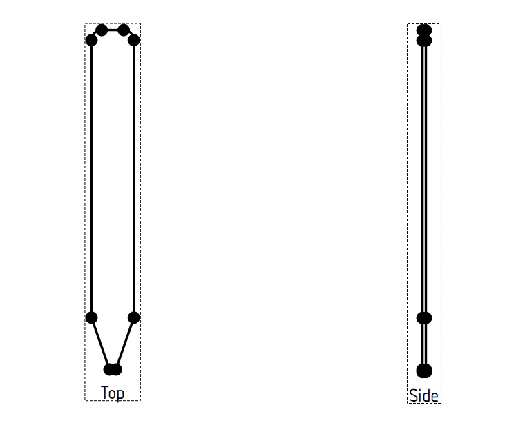

Vertices are not shown in the TechDraw workbench
Currently, the following is what I see:
As you can see, there are no vertices shown in the drawing. As such, I cannot properly add dimensions. I can add a dimension by selecting a line, but I need to be able to add directions by selecting vertices. I have tried with view frames toggled on and off to no avail.
TechDraw_ToggleFrame
full version ?
File ?
You can configure the size in Preferences>TechDraw>Scale>VertexScale.
I modified it from 5 to 25 and it doesn’t appear to do anything.
As I stated in the post, I have tried it with view frames both on, and off, but niether showed the vertexes.
If you mean full version of FreeCAD, then yes: 0.19.4-1
plant_label-stake.FCStd (28.4 KB)

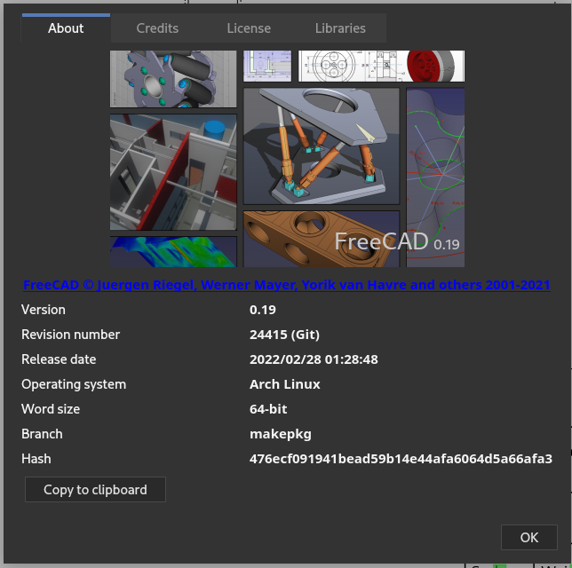

What platform are you on, please? Your “About FreeCAD” info would be great.
The vertices are shown correctly on Windows 10 in both 0.19.24267 and 0.20.28193 when I open this file:
So the problem is likely limited to the OP’s platform (probably Linux of some kind).
Please do not screenshot your About info per the forum guidelines. That is why we have a Copy to clipboard button. It also provides more info than the GUI presents. Thank you
Sorry about that. Here is the updated about info:
OS: Arch Linux (GNOME/gnome)
Version: 0.19.24415 (Git)
Branch: makepkg
Hash: 476ecf091941bead59b14e44afa6064d5a66afa3
Python version: 3.10.2
Qt version: 5.15.2
Coin version: 4.0.1
OCC version: 7.5.3
Locale: English/Canada (en_CA)
I think this is actually an issue with the Arch Linux package of FreeCAD. I installed the Flatpak version of FreeCAD instead, and the vertices are now shown. I’m not sure exactly what is different about how Arch Linux packages it that would affect this.
