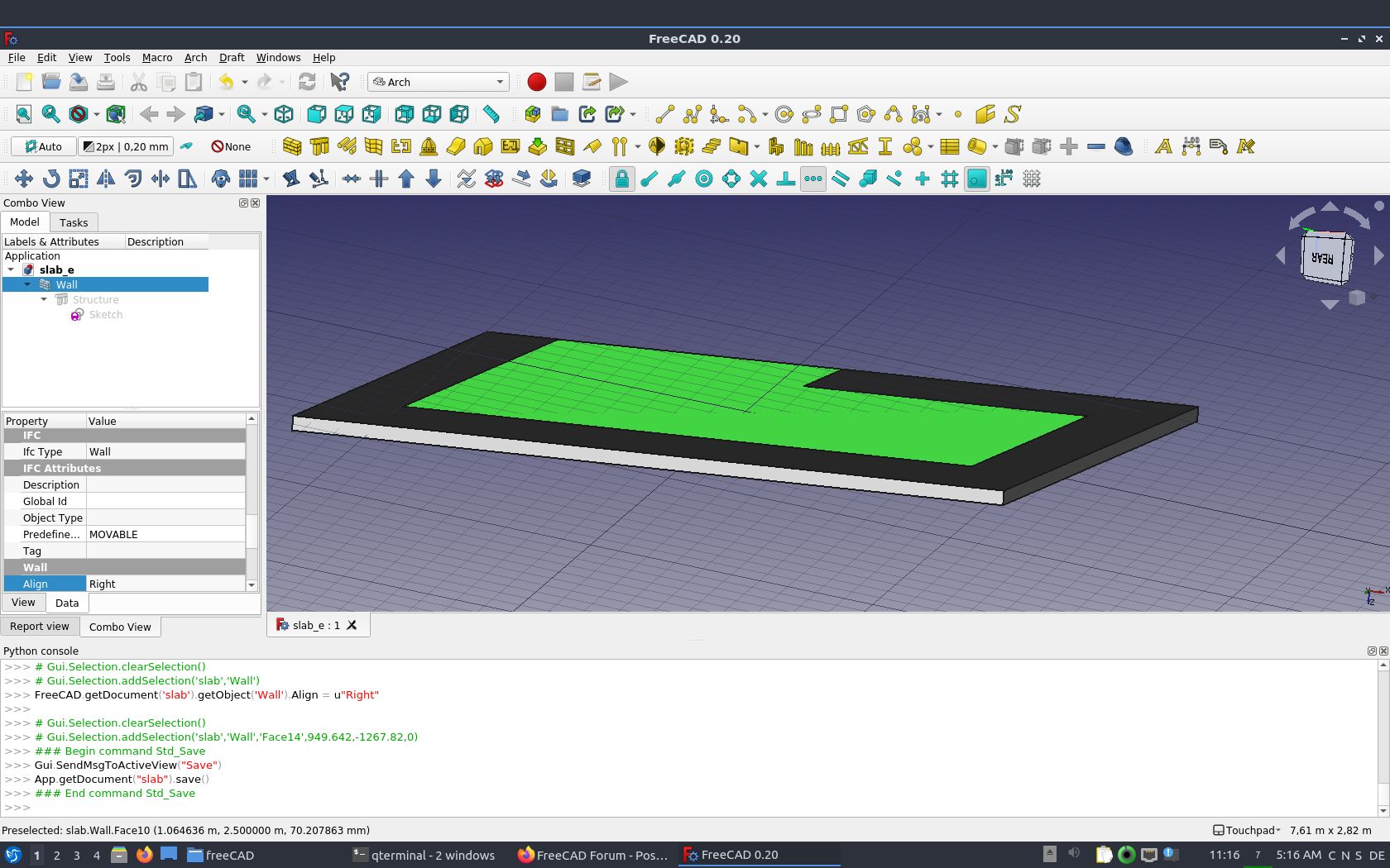

Example Workflow:-
  1. You may also (re-)use the Same Sketch and Click Arch Wall to build the enclosure
  2. Find Align in the Wall properties and select ‘Right’ so the Wall build ‘outside’ the Slab
  3. You may also set Normal in Structure to (0,0,-1) make it extrude ‘downward’ to avoid clash with walls
  4. Then you may draw another Sketch to represent the internal layout
    (Special Remark : There are others who do not use Sketch but Simple Draft Lines /Wire to build Wall)
  5. Select the Sketch / Draft Wires / Lines and Click ArchWall …
slab_ r.FCStd (23.6 KB)

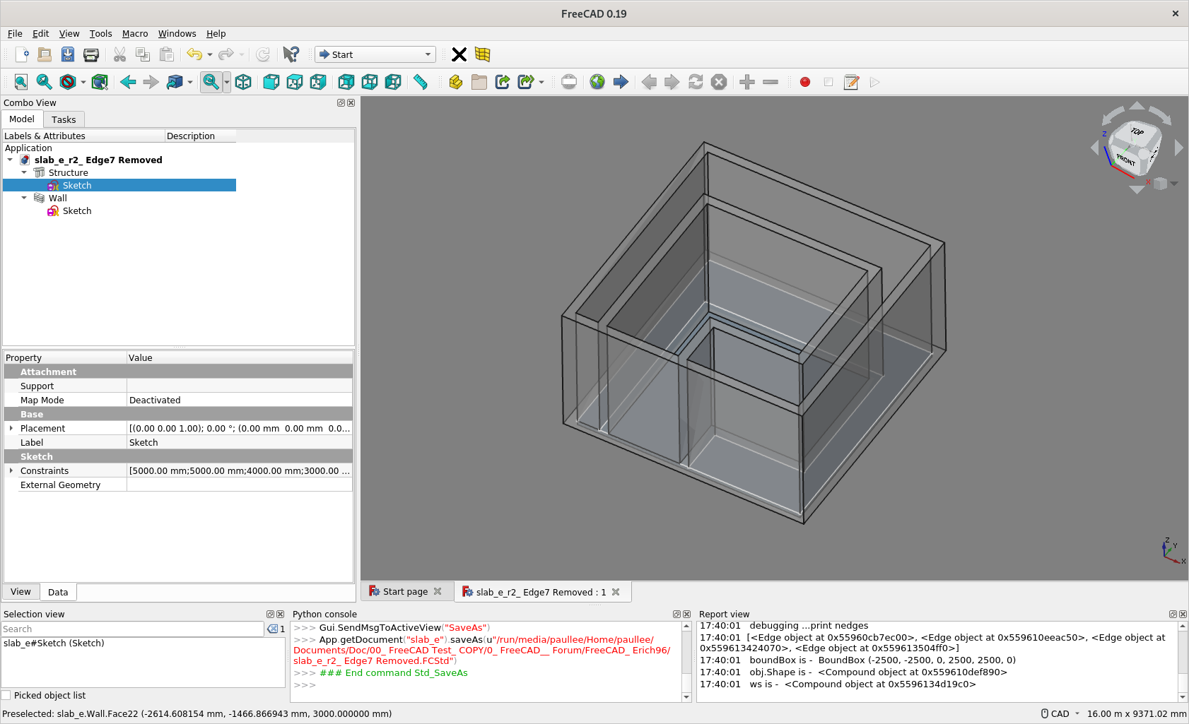

Interesting - I haven’t used a ‘complex sketch’ as Base of a Structure as you do now, it still use the outermost outline to produce a solid :slight_smile:
But you have Edge3 overlapped with Edge7 in the Sketch, that practice may produce unpredictable effect - The use of ‘Complex Sketch’ as Base of Arch Wall required more attention / care, so it seems most peoples do not use this workflow :slight_smile:
You may want to remove Edge7 to see if you layout still works.
slab_e_r.FCStd (20.4 KB)
slab_e_r2_ Edge7 Removed.FCStd (19.1 KB)

I just notice that the “Face Maker” option has an impact here. F.e. the aptly named “Cheese” face maker will create holes.

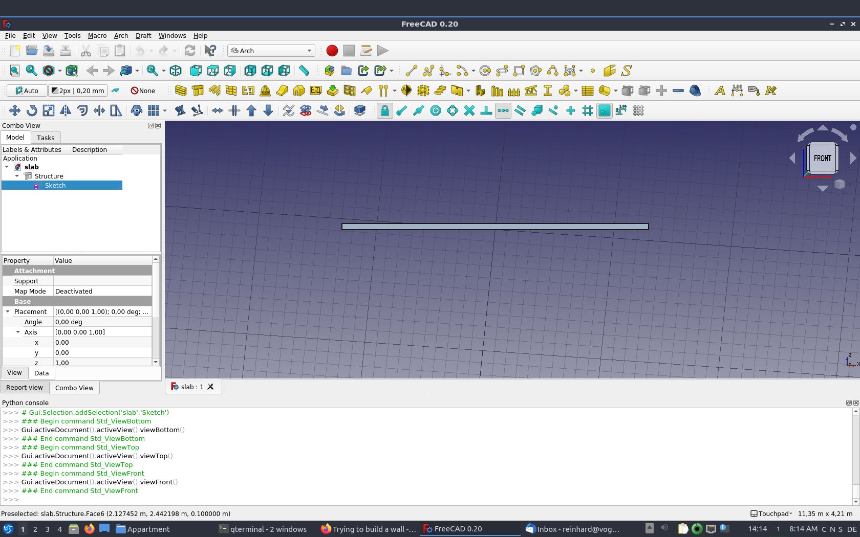

The position of the grid seems also strange to me. the first screenshot is front view, the second top view.
Should this not be normal, I have no idea how I achieved it …
It doesn’t matter for your case at the moment. The grid represent the Working Plane - Check the Draft Workbench Wiki.
There is a button to the left side of your screen with ‘Auto’ shown - which mean the alignment of the Working Plane is automatically set to e.g. align to your view.
Click it, select Top/XY (not sure as not at FreeCAD at the moment) to force it align to plan view. Then, you draw a Draft Line and they will fall on XY Working Plane.

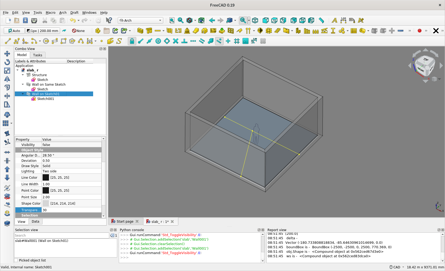

In the meantime I succeeded in creating the wall, wow !!!
The slab had in the structure the property normal with the z value set to 1, this meant that the slab was over the null in the horizontal axis(z), i.e. above the x,y surface. I set it to -1. I did this because I noticed, that in the video tutorial the slab is under the x,y plane seen from frontal view.
Then I changed to the sketcher workbench, choosed the surface (the upper one) I want the sketch to be created and clicked on the button new sketch. Designed the wall and closed the sketch. changed to architecture workbench, choosed the new sketch and pressed the wall button. That was it …
Now I will drink a beer and do the same thing later, in order to verify it’s still working …
I think also the structure is fine like that, If I add a room I can add a sketch, I think.
Remaining question for me: how to make the walls transparent as in the examples earlier in this thread from Paullee.
A further question is, if I have more rooms, the common walls, are they shared, or can they belong to one object only,
Thank you very much, now I will try to load a more complex example, I have loaded the data using magicplan on my iphone, this SW can produce data in SVG, DXF and also OBJ format. But the data has to be cleaned.
The attached picture is not nice, but it’s what I wanted …

Just find the Property panel, switch from Data Tab to View Tab. Find Transparency property, try something from 1 to 100.
