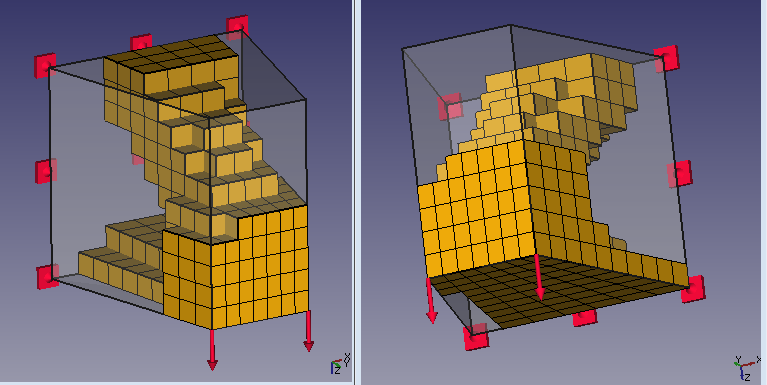

For a longer time I was working on a topology optimization script using CalculiX. I have uploaded the project to the GitHub
https://github.com/fandaL/beso
so if someone is interested, you can follow description there and try it. Current state is that I tested it on very simple examples; theoretically it should work also on more complex models, it needs slightly more FEM understanding, more model preparation, and much more computational power. I’m slowly learning programming on this so the quality of the code is corresponding, therefore critical comments are welcomed although I might not be able to correct everything. There is also still a lot of basic stuff to implement and connect to a FreeCAD functionality.
And for picture readers :slight_smile:
Transparent material is initial volume (filled by a mesh) and depicted mesh is final result after removal by algorithm. It is a proposal of material distribution in a lever loaded by the force on the right side, with horizontal fix on the top, and constrained displacement in radial and axial direction on the middle ring (so it can turn around the middle ring centre)

At the moment it is possible to use 1st or 2nd order triangle and 1st or 2nd order tetrahedron. Script computes centres of gravity and volume of those elements. At the moment these calculations are with certain inaccuracy for 2nd order elements because there are used the same formulas as for 1st order elements.
Is this somehow a limitation of Calculix?
CalxuliX can calculate volumes (may be I will use them), but I didn’t found CalculiX to output centres of gravity or, even better, position of integration points. I plan to ask someone about integration over an element shape function which could solve these problems.

Support for other element types passed my testing - simple 3D model and 2D (different one) model with edge load. It should be possible use all element types in optimization domain except beam elements. Beam elements can be in the model but not in optimization domain.
What was clearly visible was computation time - for 2nd order elements 4-8 times longer than for 1st order elements for same number of elements. I didn’t focus on differences in quality, but 2D models gave different topology for different element types.
In these cases all was one optimization domain, so edge load on the shell model is “in the air” after process.
Very interesting that different elements give different results, even if you use hundreds of them. Would be interesting what the reason for this is. Mhh neiter nature nor materials does not know femelements. Which one is best ?! It is may be like a path. If the optimizer is on a specific path it just goes this way. There must be academic papers about this.
Mhh and tria3 give a better result than tria6 and quad4 (IMHO) really strange …
