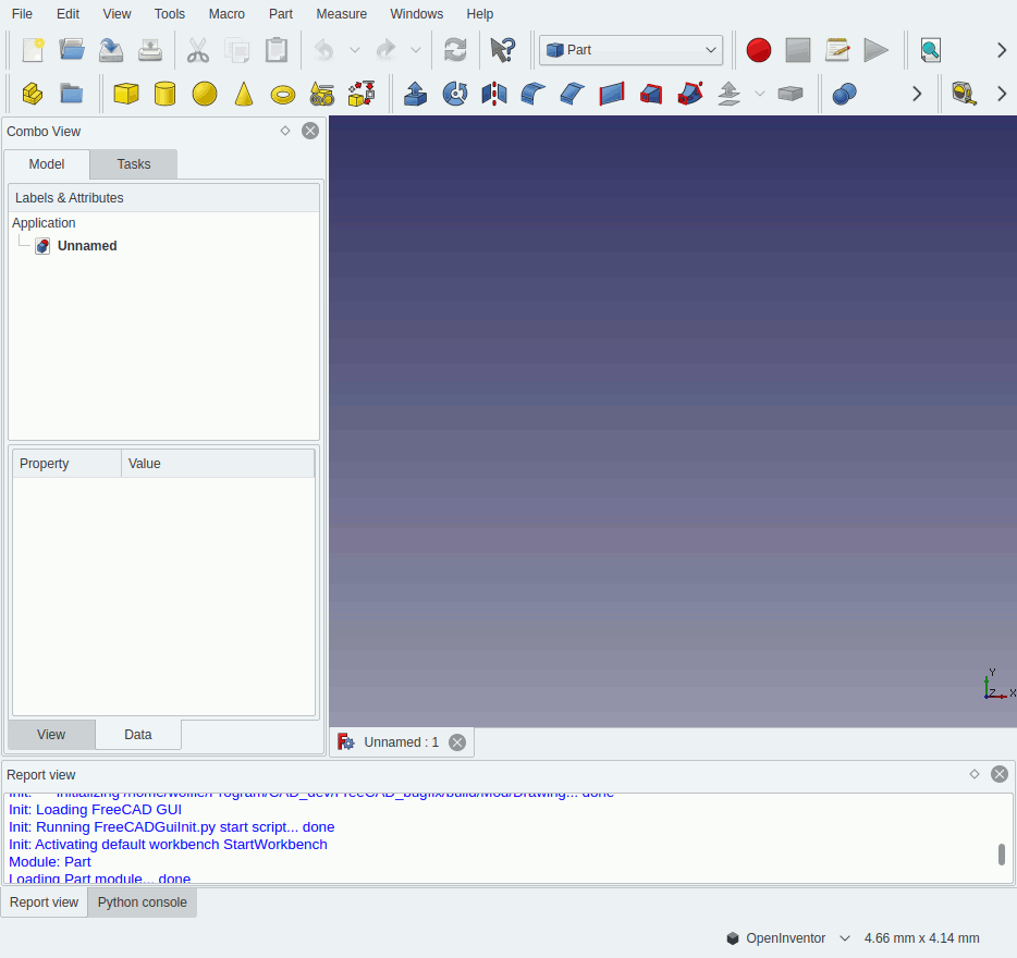

This post is to showcase a c++ implementation (and improvement) of the python topo namer that I linked above. without further ado, here’s a (very crude) gif showing it in action!
And here’s a (equally crude) gif showing the current FreeCAD behaviour:
(If anyone can tell me how to resize these on the forum I can make them a bit smaller)
I’m very excited to show this! I originally wanted to also post a gif of the current behaviour (i.e. the fillet moves when the cylinder is made shorter) but my ‘vanilla’ version of FreeCAD isn’t done compiling yet.(it finished) I also wanted to do a fancy screencast gif, but I wasn’t able to make the screencast thing work, so I just took some screenshots and used gimp to make the gif.
Anyway, let me explain (briefly, and at a high level) how this works. I’ve created a library that (for now) I’m calling TopoManagers which describes a Topological Manager interface (ISolidManager) as well as two concrete implementations of this interface: PrimitiveSolidManager and CompoundSolidManager. This line in a test for the PrimitiveSolidManager shows how the manager can be used to obtain a “constant reference” to a topological edge. Note that this reference is a simple integer, but it is guaranteed to always return the same edge.
I have a TopoManager branch of FreeCAD that shows these managers in action (I have not rebased against master in a week or two, please excuse my excitement to post this as soon as possible.) In particular, notice that I’ve added a new member variable to Part::PropertyPartShape, as well as a getter and setter for that variable.
The use of this variable (a unique_ptr to an ISolidManager) is easiest shown in Part::Box. You can see that we retreive the ISolidManager, then either initialize it or update it as appropriate. The update is done using a helper class “Occ::ModifiedSolid” which carries information needed to keep track of which faces have changed (or been deleted or generated).
It’s that simple! You can also look at Part::Cylinder for another (almost identical) use-case, as well as Part::Boolean for a more complicated use-case (this one uses CompoundSolidManager).
I don’t want to get too deep into the technical details of how this works on this post for two reasons: one, my wife is hungry and I need to cook dinner :laughing: And two…actually, that’s the only reason. I will give a little bit of detail though.
The way this works is essentially by using the method whereby each Edge is described by the two faces that make it up. As such, as long as we know how each Face changes, we can consistently refer to a given edge as “the common edge between FaceX and FaceY”. It’s that simple! My library simply provides facilities for (more) easily keeping track of these face changes.

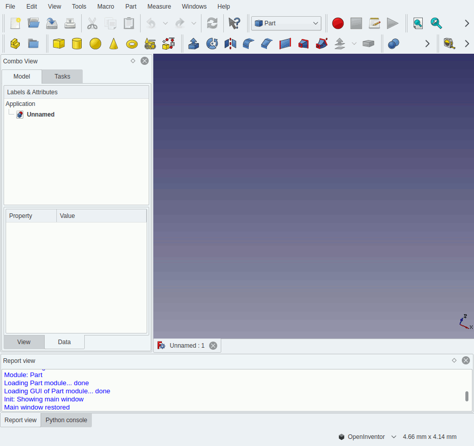

I’ve updated my TopoManager implementation to deal with split edges. Here is the current behaviour in FreeCAD:
And here is the behaviour with my TopoManager being used:
The TopoManager branch of my FreeCAD github repo is up-to-date with this fix. I’ll admit that my FreeCAD integration is a bit hackey: in particular, I could not figure out how use FreeCAD’s Placement to update my solid manager so I just did it without Placement. I realize I could add some code to the appropriate place in Part::Feature, but the return value on this->getManager() is a constant reference, and since it returns a reference to an abstract base class, Part::Feature doesn’t have enough information to make a new one.
This is a limitation in my own understanding of good programming design.
Any way, my FreeCAD integration was not intended to be complete or necessarily elegant. It was intended as a proof-of-concept, or maybe a proof-of-solution. My topological naming solution works irrespective of FreeCAD (though it does need more work, of course), and I merely wanted to show an example of how it could be integrated into FreeCAD to solve this issue that is so near and dear to all of our hearts.
My intent is to generate some conversation about:
a) Is this a good approach? Is this solution one that we feel could be integrated into the FreeCAD code base?
b) If so, what would be the correct way to do this? For now I’ve tapped into individual Part::Feature’s (i.e. Part::Box, Part::Boolean, etc..) but would it make sense to implement my solution more generally?
c) If not, what doesn’t work? What could be better/different?
