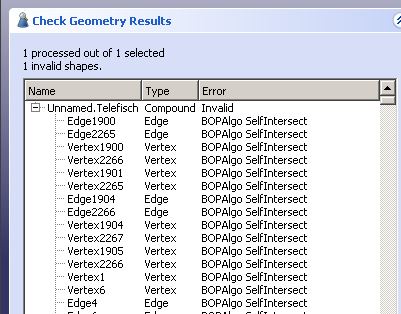

The IGES model is not imported in a usable form. I do not know if the IGES is broken or if FreeCAD is not importing correctly. In either case the imported model has hundreds of errors and is not a solid.
Gene
Thanks for checking that. So much for trusting solid model export formats :confused:
My initial thought process was just to get the important geometry of your design into a sketch. Am quite often importing SVG files as 2D geometry for machining, so ‘Draft to Sketch’ is something I fall back on quite a lot.
However, I just had another look at your model, and appears there’s a much easier way! Import the IGES model, open the Part workbench, and use ‘Part → Convert to solid’. The resulting solid (with no errors shown in it) can then be used directly for the adaptive path.
I’ve uploaded another file using this approach here
