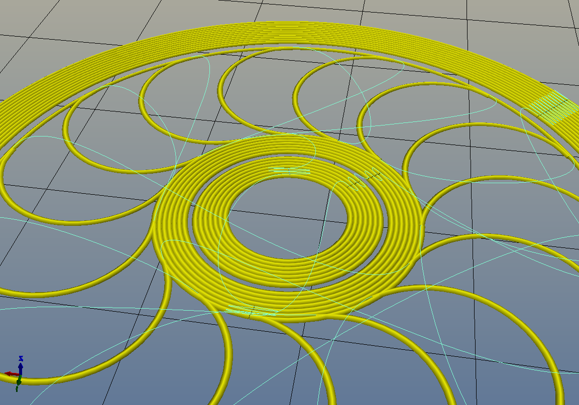

Hey! I have first results
So nice !
This really reminds me those beautiful Volumill paths ! https://www.google.it/search?q=volumill+path&es_sm=122&source=lnms&tbm=isch&sa=X&ved=0CAgQ_AUoAmoVChMI_s2g2vn9xgIVBfByCh2FlQT4&biw=883&bih=719
OK, the spline generator is working perfectly (except it is a bit slow, VB6’s classes are a problem).
I have a bit of a problem that I can’t change feedrate in real time without causing speed mismatch (repetier-host seems to be smart enough to not affect travel moves, which was fine when the moves were straight lines…). But it’s not a big problem, this doesn’t add too much shake (speed changes involved are rather small compared to what it was when moving in straight line)
Still not ready for real printing, though, but it’s coming… In VB now.
Looking nice!
