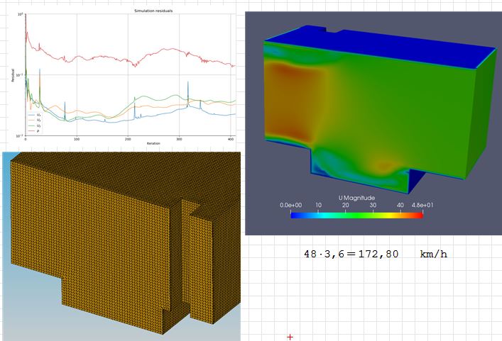

I can only guess: coarse mesh, no mesh refinement zones, no boundary layers for turbulence model.
picture: my run with simplefoam, laminar approach. (v_max 170 km/h???)
BTW: what do you want to simulate?

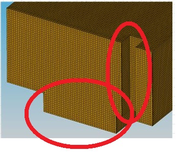

Constructive discussion ! I appriciate that a lot ! Basically I want see the stream in / around the two structures (red circles in picture).
(…has to do with stream in clean room service, particle separation etc.)
Regarding the velocity: I have to check but it should be 0.2 m/s =approx. 0.8 km/h. Maybe I did some mistake during input. (simulation is

But: at v=0,2 m/s and a step height of 100 mm I get Re=1330. This is very low and should be done
with a laminar calculation in the first step.
