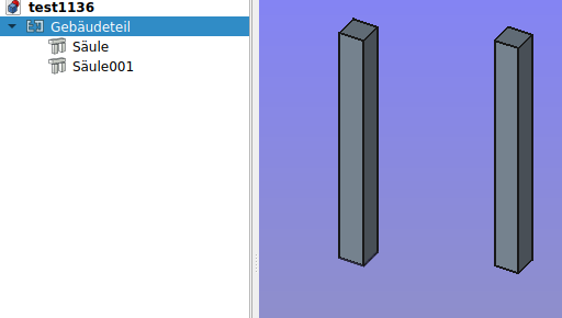

Selection of building part does not highlight the part in the 3d window
selection of building part does not highlight the part in the 3d window, Is it wanted like that? is it the same with you?

Yes, the building part is basically a group, not a physical object. I don’t think it should have an “existence” in the 3D view (other than its label).
But I think it would be possible to, if the building part is selected in the tree, highlight its child objects, without selecting anything. That might be a good thing to have… (one would be able to disable that, of course)
yes I think that’s good too
