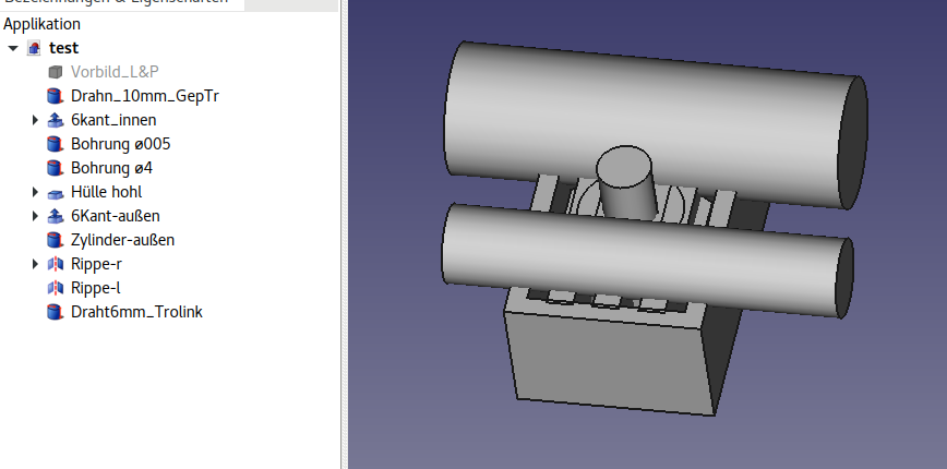

This was my idea.
A part, designed of of a number of parts, fusioned, cut, chamferd etc:
Now I need a change in the “deep down hierarchy” parts - let’s say: change thickness of the “Rippe” parts:
You can try to make the alterations directly - this may or may not be successful.
The safe way is to “destroy” the part - meaning: remove all cuts, fusions, chamfers etc:
You get all your components:
Then you can make your alteration - and re-do all the cuts, fusions, chamfers you did before etc.
You need to pay attention not to make a mistake, and it takes time. And if you have to do it several times (I always have to…), it’s quite annoying.
So - couldn’t we have a possibility to “record” all the fusions, cuts, chamfers etc, to do the rebuilding automatically?
We can think about more sophisticated features in addition - enabling other parts to be added, change s simple step in rebuilding by a stop of the rebuild process where the user wants it etc.
But first - let’s talk about the “automatic rebuild” feature.
Am I more clear now?
