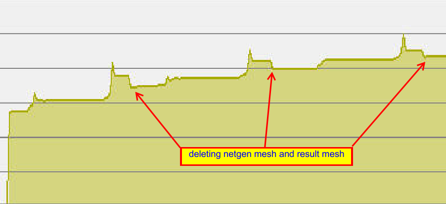

3 full cycles:
  • meshing (netgen)
  • solving
  • delete mesh and result
Edit->Preferences->General->Document->Using Undo: Unchecked
It’s obvious now. Does exist a way to disable undo for one operation only ?
No because this would make the whole undo/redo system unusable. But this anyway isn’t the part that causes the leak.
I have detected two functions that leaks memory:
DriverUNV_W_SMDS_Mesh::Perform() – around 100MB for each call in debug mode
ViewProviderFEMMeshBuilder::createMesh – around 700MB for each call in debug mode
One major memory leak is in the methods SMDS_MeshNode::X,Y,Z. Internally they invoke SMDS_MeshNode::getCoord which allocates memory on the heap for three doubles but the calling instances don’t free it.
Edit: It appeared that this leak is responsible for the leaks in DriverUNV_W_SMDS_Mesh::Perform() and ViewProviderFEMMeshBuilder::createMesh and fixing it solves all the mentioned leaks.
3 full cycles:
  • meshing (netgen)
  • solving
