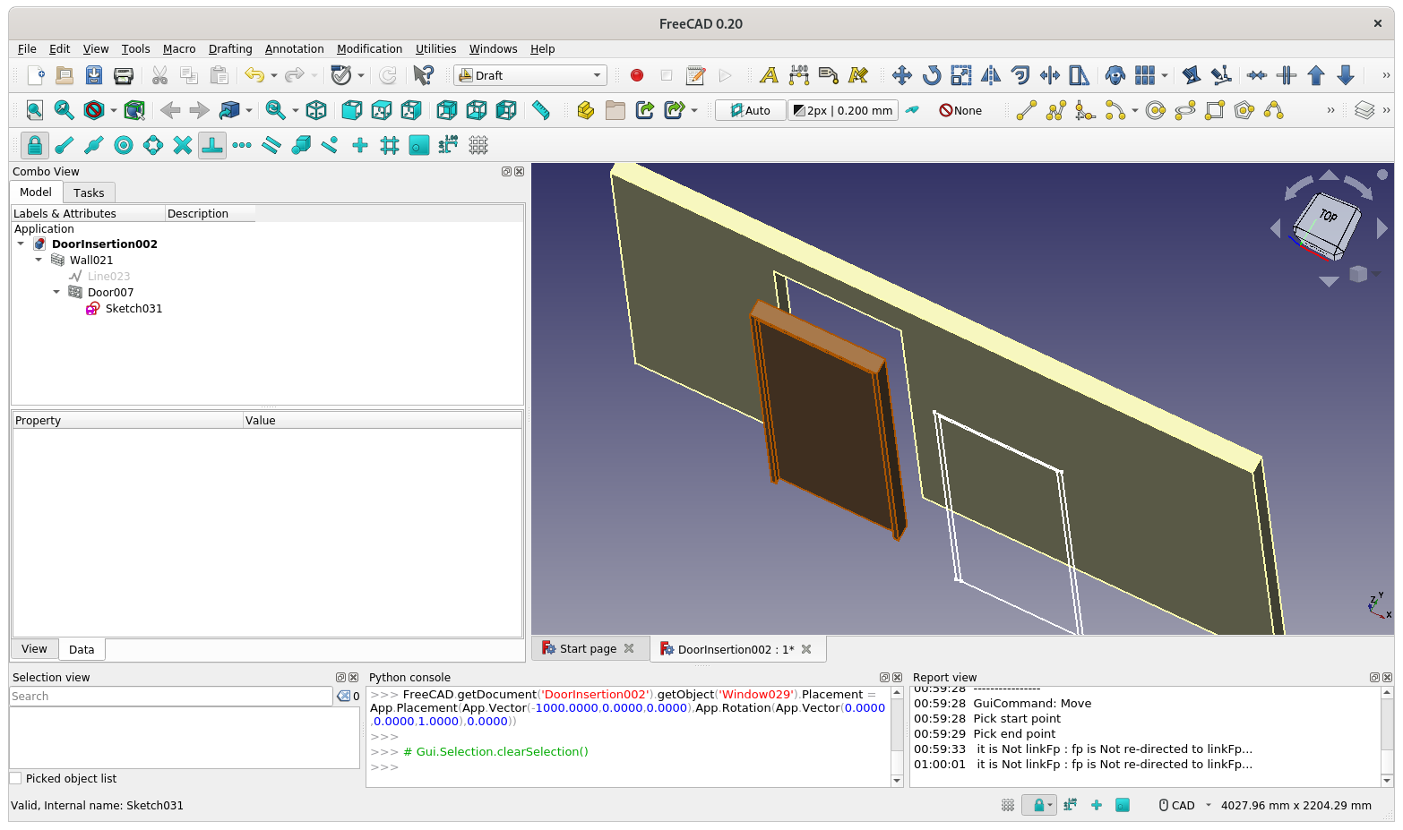

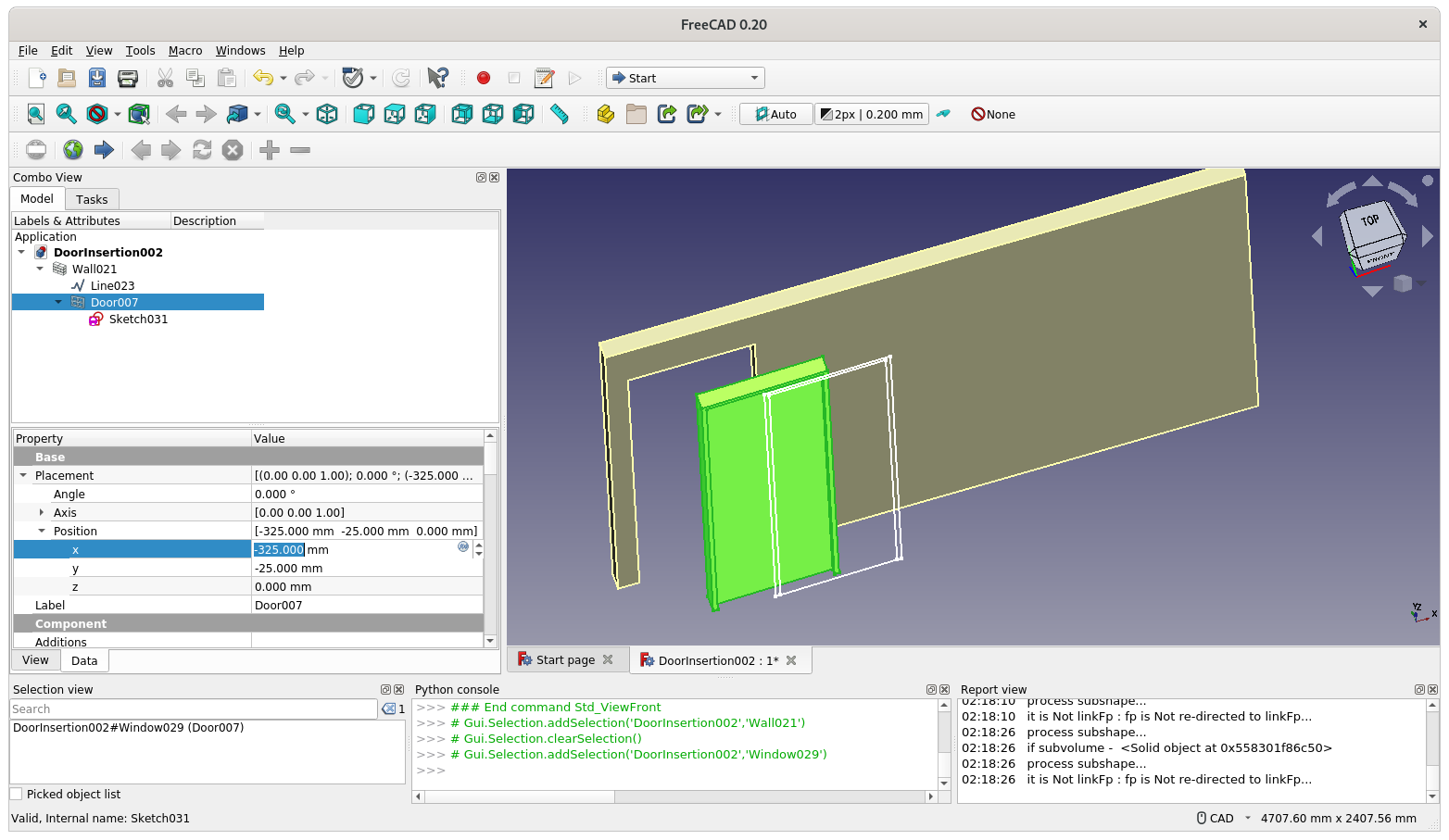

Can someone explain why sometimes when I Draft/Arch/Bim Move a Window or Door it becomes disconnected from the opening in its Host wall? The attached file DoorInsertion002.FCStd demonstrates my problem. The door is currently not in the Wall opening, and moving it further along the Wall makes the situation worse. Try it.
The file was extracted from a larger project by copy and paste and for another reason that I don’t understand the Line on which the Wall was built is now distant from the Wall. That is an aberration of the copy and paste as it is correctly positioned in the original. In any case it doesn’t seem to have had any effect on the failure of the Wall opening to move in unison with the Door.

It seems there is a bug here … (the opening go in opposite direction with the Wall object is rotated around Z-axis by 180 deg). Anyone like to fix this ?

I acknowledge that many versions back the whole building of which this wall is just one small part was rotated through 180 degrees, and it would seem that this is the cause of the problem.

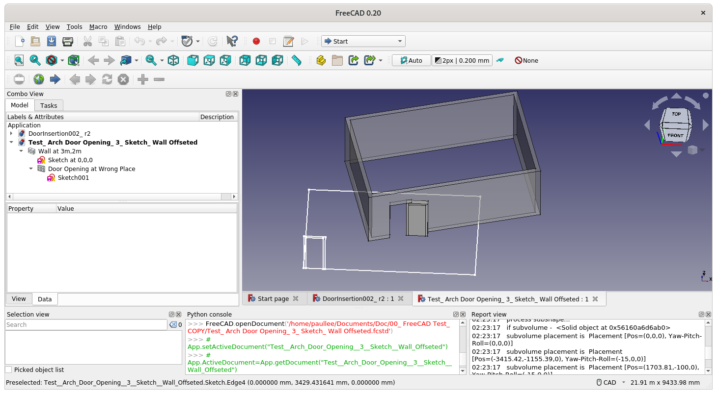

It seems the order of inversing placement needs to take in account of the Window’s placement, and below rectify the problem?
                            #subvolume.Placement = subvolume.Placement.multiply(placement)
                            subPl = FreeCAD.Placement()
                            print (" subvolume placement is ", subPl)
                            subPl = subPl.multiply(placement)  # inverse placement of Wall object
                            subPl = subPl.multiply(subvolume.Placement) # placementof Window (Opening) object
                            subvolume.Placement = subPl

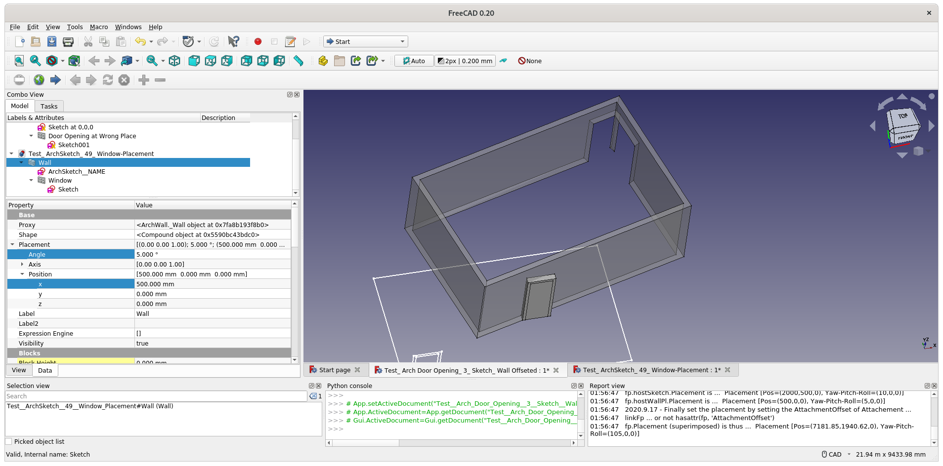

Hmmm, for some reason, the inverse_matrix method is not working ?

On line 721 you have:
placement = placement.inverse()
On line 729 you have:
inv_matrix = placement.Matrix.inverse()
In other words you are applying the inversion twice.
This code works.
It can be reduced to this line:
                            subvolume.Placement = placement.multiply(subvolume.Placement)
If you compare it to the original code (line 786) there is only a subtle difference:
I have to admit that I do not understand this difference.
Note that the .Placement.multiply(placement) structure occurs elsewhere in the file. I suppose it would have to be changed there as well?
Thanks. I understand the multiplication of placement is not ‘commutative’ in mathematics sense - so multiplication needs to be in the particular order of successive placement manipulation.

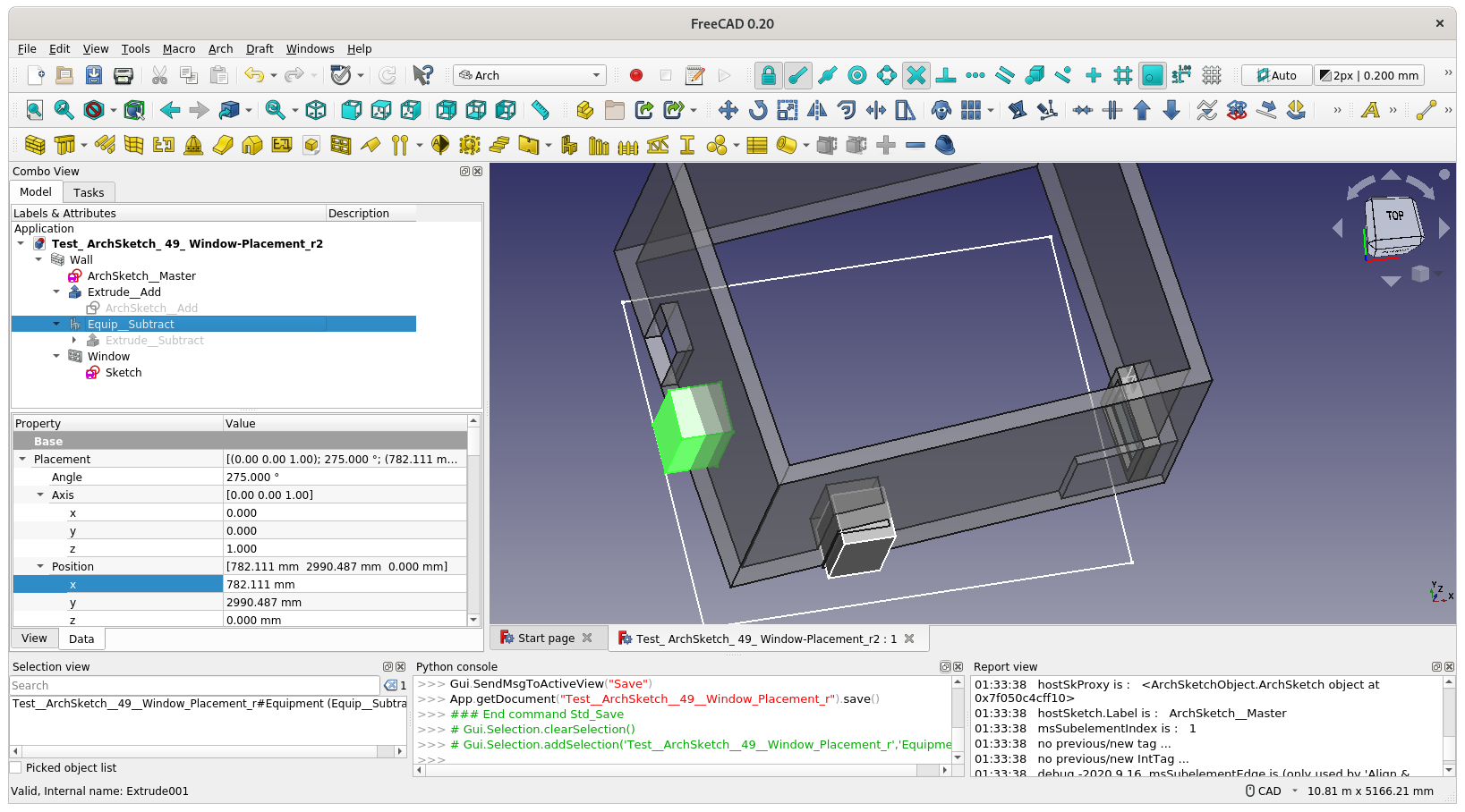

And further examining other Additions / Subtraction cases, and the bug seems exist. It can be shown that only Window object (getSubVolume) works correctly.
Test_ ArchSketch_ 49_ Window-Placement_r2.FCStd (63.9 KB)
