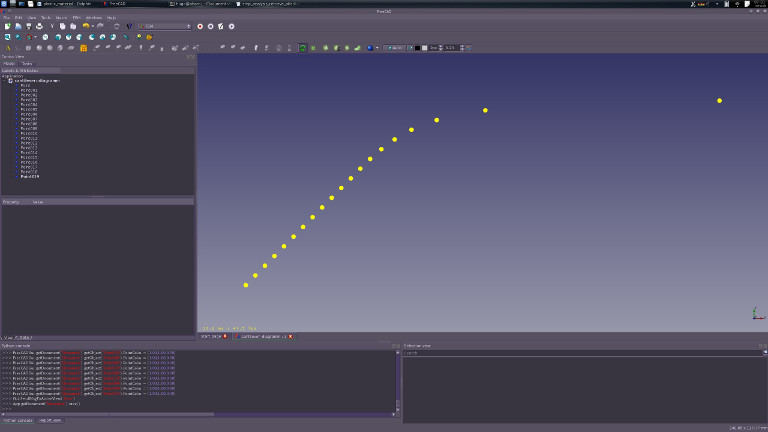

Attached an simple example and an example diagramm I made of the result objects.
cantilever–plastic_without_results.fcstd (519 KB)
code to make the diagram dots
absdis = []
for o in App.ActiveDocument.Objects:
    if o.isDerivedFrom('Fem::FemResultObject'):
        print o.Name, ' --> ', o.Stats[11]
        absdis.append(o.Stats[11])
end_force = App.ActiveDocument.FemConstraintForce.Force
stepcount = len(absdis)
step_force = 1.0 * end_force / stepcount
start_force = step_force
data = []
i = 0
force = start_force
for d in absdis:
    d = (force, absdis[i])
    i += 1
    force += step_force
    data.append(d)
for d in data:
    print d[0], ' --> ', d[1]
# draw a diagramm with Draft
import Draft
for d in data:
    Draft.makePoint(d[1], d[0] * 0.00001,0)
Gui.SendMsgToActiveView("ViewFit")
