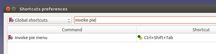

Make sure you have the latest version of PieMenu module installed. Now one can change the pie menu invoke shortcut by using ShortCuts module.
How to do it without having to install/have installed the ShortCuts module?
Look above at the answer provided by @adrianinsaval.
