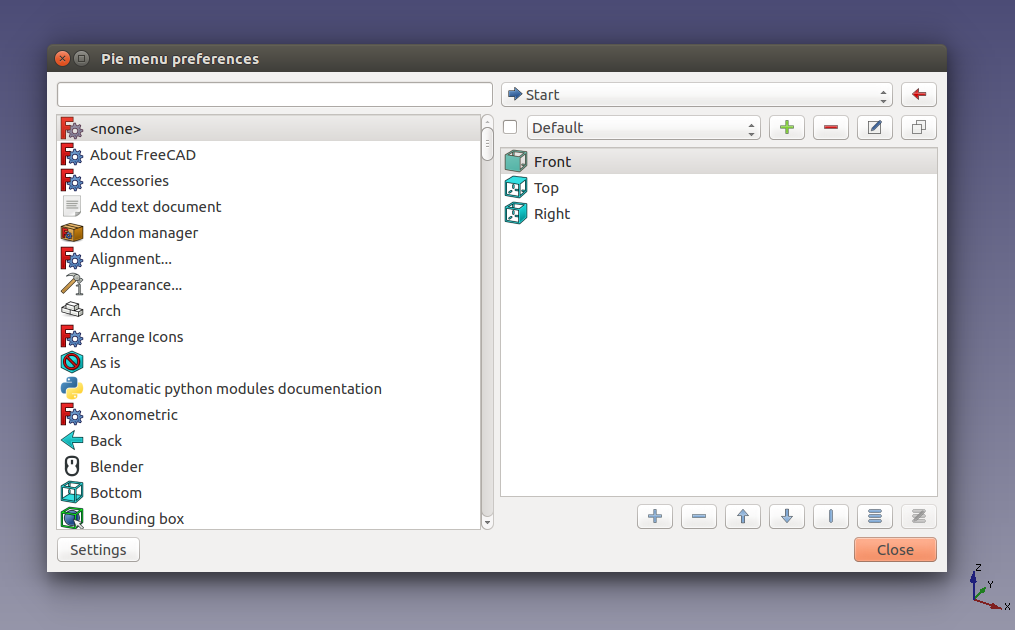

Updating to the latest revision should add Accessories → Pie menu entry to the global menu. This brings the back end logic and the preferences panel from the command panel module to pie menu. Current front and back end will continue to work as is, not affected by this change. Feel free to press on everything and try to figure out things like on how to create and set a new global or workbench specific (sub) menu, to add commands to it, set is as default, rename it, delete it, export commands from the toolbar to a menu, reset the work done …
P.S. Feedback appreciated, especially if something doesn’t work as expected. Should be Py2/Py3/Qt4/Qt5 compatible. As for the font end, i can’t promise to start working on it before March, as when the free time allows, a few other FreeCAD related things are currently higher on the priority list.
