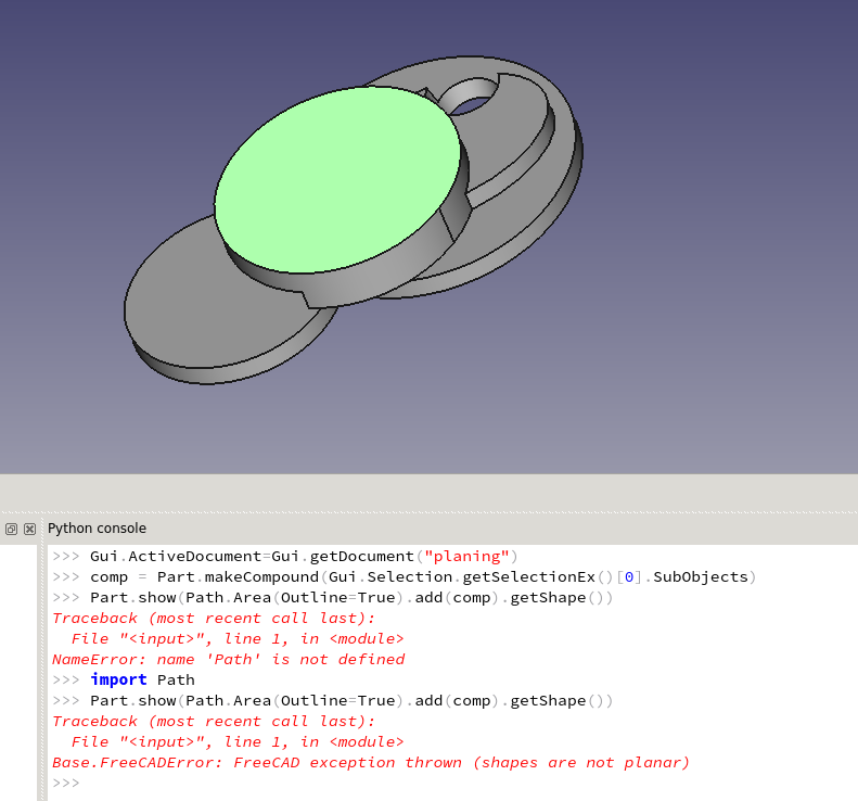

If I get a reference to the lower face in the model (Face14) and do
shape = Path.Area(Outline=True).add(sub).getShape() it works as you describe.
But if I get a reference to the top face (Face13) and do the same thing, I get an error that the face is not planar. However,
DraftGeomUtils.isPlanar(sub) returns True for the same face.
Interestingly, if I select both Face13 and Face14, it works.
Could you please show me your exact code? I just tried it and it works. Are you sure you have pulled my latest commit?
comp = Part.makeCompound(Gui.Selection.getSelectionEx()[0].SubObjects)
Part.show(Path.Area(Outline=True).add(comp).getShape())
My code is effectively the same as yours. I double checked and I’ve merged your branch as of: 56a3501
Running your code snippet, I get the error.
The rest of my FreeCAD info
OS: Linux Mint 18 Sarah
Version: 0.17.11043 +22 (Git)
Build type: Unknown
Branch: feature/PathAreaOps
Hash: 58f106023066cbfbafbe43432b242981a7dee6dc
Python version: 2.7.12
Qt version: 4.8.7
OCC version: 6.8.0.oce-0.17
Could you please try with OpenCascade official version. That’s the only difference I can tell. I am building with OCE right now. Anyway, I think FC 0.17 is moving to OCCT 7, so you might as well switch to the official library now.
Yes, that did it. Resuming my testing… So far, looks good. :smiley:
Yes, it is OCE problem. And I’ve just fixed it. Please try. I’d still strongly suggest you to switch to OCCT 7. It has improved on a lot of other things.
confirmed fixed with occ 6.8.
