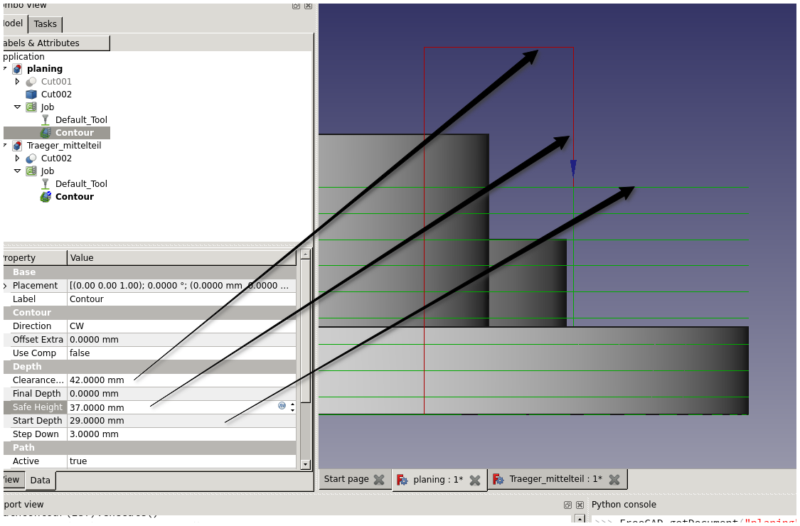

Now that I’m starting to get the hang of this, I’m really excited. Rearranging my contour code made a big difference in speed and I still haven’t been able to stump the projection algorithm with a shape yet. :smiley:
After re-arranging, CW/CCW is still reversed but the bug I mentioned where one step-down was going in the opposite direction has disappeared. I think that was a red-herring in my operation.
The clearance/safe height issue remains and this might help you whenever you get to it. In this image, the cutter would perform a rapid move all the way from clearance to the first section height. That would be a crash because it’s cutting through material from safe-height to start-depth. It correctly performs a feed move between section layers but not to the first section. Setting the start depth to the top of the material doesn’t work because then the first entire profile is done without cutting anything.

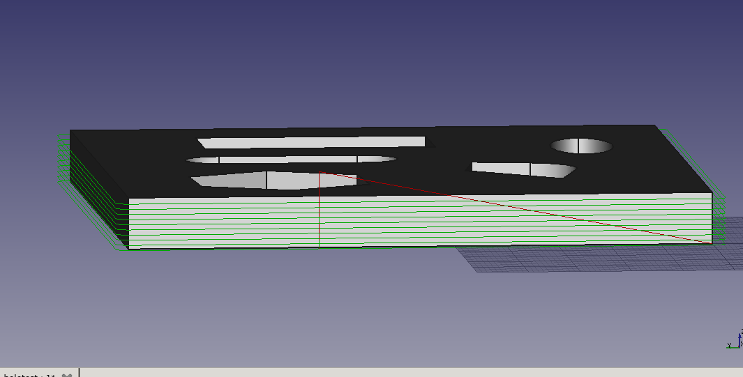

Working more with Projection and sections I hit some weirdness.
I want to create a solid that represents the outside perimeter without the inside holes. Then I can subtract the original part from it to find the material to be removed without worrying about the perimeter profile. I call this part the ‘envelope’ and I wrote a macro to create it.
import Path
from PathScripts import PathUtils as PU
obj = Gui.Selection.getSelectionEx()[0].Object
def getEnvelope(shape):
    area = Path.Area(Fill=1, Coplanar=0).add(shape)
    area.setPlane(Part.makeCircle(10))
    sec = area.makeSections(heights=[1.0], project=True)[0].getShape(rebuild=True)
    return sec.extrude(FreeCAD.Vector(0, 0, shape.BoundBox.ZMax))
Part.show(getEnvelope(obj.Shape))
But when I repeatedly run the macro with the same original part, I get different results for the envelope. Image below shows the original part at left, and envelopes created from four runs. The first and third are correct but the other two are wrong in different ways. I assume Area is caching the added shapes but I’m not sure how to clear it.
drilling.fcstd (232 KB)
I can confirm this a bug in Area. I’ll try to fix it soon.
This probably has something to do with the loop orientation bug you’ve found early, and the problem is a complex one. I’ll propose a compromised change, and I want your opinion first. The change is to limit the orientation as 0=None, and 1=Reversed. The reason is that the CW and CCW notion actually depends on whether the wire is for outline or inner hole. Profiling operation contain both type of wires, while pocket (if the pattern are closed wires) are all inner wires. For inner wires, the material is in fact at the opposite side comparing to the outer wire. So for climb milling you’ll want CW for outer wire, and CCW for inner wire.
OCC, when making face, use CCW for outer wire and CW for inner wire. However, the problem is complicated by the fact that CW and CCW depends on the direction of the surface normal, or in layman’s term, depends on which direction you are looking at. To make things manageable, Area will make an assumption that the face normal shall be pointing towards (0,0,1) direction. WorkPlane is used to let user control how to transform the actual wire plane into this direction. In another word, Area will internally transform the wire so that the work plane’s normal align with (0,0,1) before any further processing. Before orientation adjustment, Area shall normalize all wires orientation, so that the outer wire is CCW, and inner wires is CW with regarding (0,0,1) direction. So now, you can see why it makes sense to just having two options for orientation. ‘None’ means keep the original orientation, which corresponds to conventional milling, and ‘Reversed’ for climb milling.
Path.fromShapes() will not have enough information to determine which wire is supposed to be outer and which is inner. So it just assumes the orientation of the input wires are already normalized, and simply reverse it if orientation=‘Reversed’. Any suggestion?
