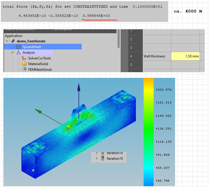

Hi, very interesting work.
I ran your example with the predefined values, macro runs.
My workflow:
open file, remesh part (max el-size 2 mm), write inp, close dialog, run macro.
When I understand your macro right, it does this:
Start with 1,5 mm wall thickness as described in spreadsheet,
change thickness with 0,25 mm every step until max-sigma 150 MPa in the wall alone is reached. Right?
If so, this is exactly what in need for calculating flange-stiffeners :slight_smile:
I run on intel i5 16 GB-Ram HP-laptop.
FreeCAD:
Version: 0.19.24267 (Git)
Hash: b2ca86d8d72b636011a73394bf9bcdedb3b109b7
Python version: 3.6.8
Qt version: 5.12.1
Some pics for the other folks:

The terminology isn’t very good yet either, i think i’ll rename “checks” to “conditions”. “Chances” also sounds a bit off, but i can’t think of a better fitting word. Feel free to suggest better names for other wonky sounding labels as well :smiley:.
I stuck this up top as i’ll be using that terminology from now on in this post.
First, a huge thanks for testing it out and taking screenshots!
The necessary workflow is: open file, run macro. It should take care of all the rest.
The file has to contain: FEM analysis object, FEM mesh and a FEM solver. FEMIterate should find them all automatically, but if it doesn’t then it’s possible to select them manually from the “Objects” tab.
It won’t hurt to mesh and solve once by hand just to see that all is working well, as it should delete all previous FEM results. This does mean that it is not possible to edit the solver input file, FEMIterate will simply overwrite all the edits.
No, it doesn’t discriminate any part of the result mesh. The condition will have to apply for the whole result mesh.
Other than that, it’s exactly the function of this tool.
On the picture you posted there is a message in the Log box: “Hit iteration limit without finding a solution”. That means that it ran for 20 times but the conditions didn’t pass. I’ll color the errors red so they’re a bit more noticeable at a quick glance.
I am not sure why that happened. If you check the FEM mesh results is the wall thickness increasing with each iteration?
It would be cool to allow to have different conditions for different groups of the FEM result, but i have no idea on how to implement it. The way it works is that the r variable in the condition expression gets set to the FEM result object for that iteration (labeled IterationX). So the “max(r.vonMises)” takes the maximum result from the values array. It just contains an array of numbers and i don’t know if/how it’s possible to associate them with volumes for conditions.
To test out more complex conditions one could do a calculation with the built-in solver, send the FEM result to the Python console via the right click menu and then assign it to r (“r = obj” in Python console). After that expressions can be entered exactly the same way as in the FEMIterate tool (sans other variables, but you get the gist). Expressions should return a truthy value (True or not 0) for FEMIterate to mark that condition as passed. All conditions must pass for the iteration to stop.

No, I still get the full iteration-limit. Even when playing with the parameters.
There is a little difference in the stresses between 1. and 20. iteration, but no
visible change in the result-meshes.
