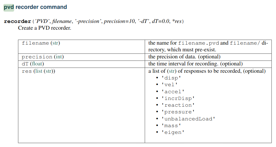

opensees can export to .pvd format that supported with paraview:
this brief file is also useful:
http://marcel-ritter.com/wp-content/uploads/2016/10/FEMOpenSeesPoster.pdf
thanks to openseespy, we can write opensees input file in python format and benefit from all of python library!
https://openseespydoc.readthedocs.io/en/latest/

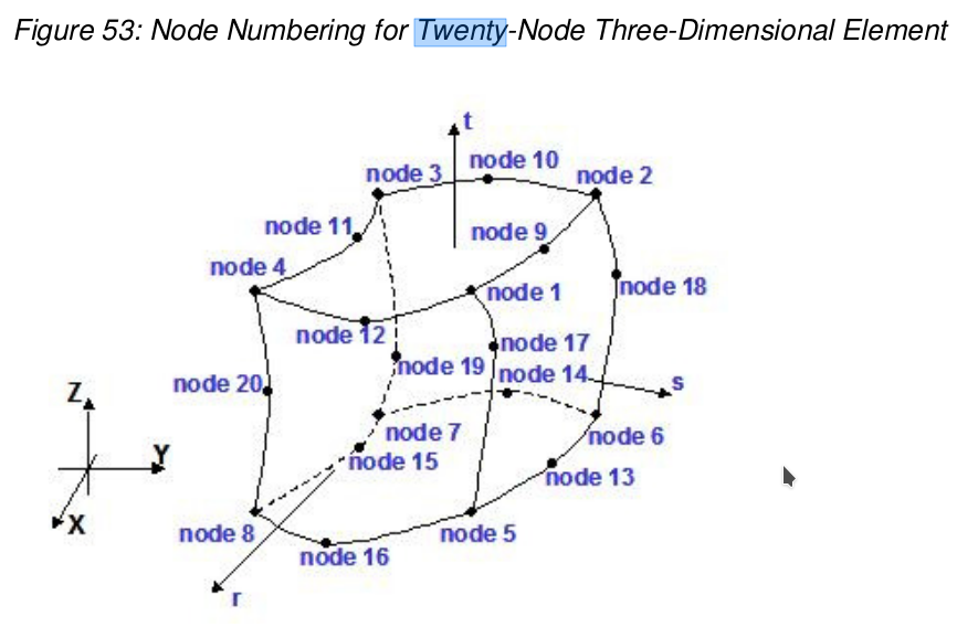

@bernd, i searched for equivalent Ten-node tetrahedral element for opensees, but i can’t find it.
for preparing 3D contilever, how can i change the element type in FreeCAD, for example one that had been used in original example in calculix site:
C3D20 http://web.mit.edu/calculix_v2.7/CalculiX/ccx_2.7/doc/ccx/node29.html
command for this element in opensees:
I would not care about the element type ATM. If opesees uses a twenty node brick element it will be fine too. It does not mater which element type we gone use. Both should give the nearly same deflection and stress if we use enought elements.
ATM it is not possible to make a brick20 mesh with the gui in FreeCAD but I will create one for the calculix cantilever.
