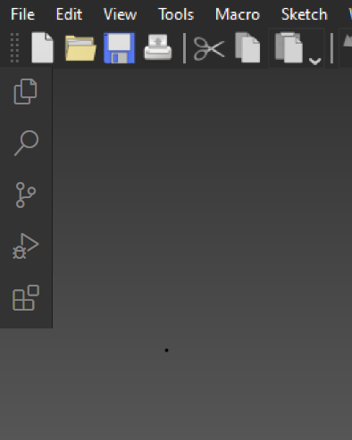

And/or using side tabs that let you open these panels on the go, this as an alternative too the autohide function in Linkstage.
Example from Ms Code.
I like the idea of an overlayed toolbar, regarding data and view properties grouping i actually prefer the tabs, much easier to switch from one to the other. A sidebar to control active panels is also a good idea IMO.
Can probably do the sidebar with just macro buttons, I’ll try tomorrow.
Made the macro’s, wasn’t that hard with this macro:
https://wiki.freecadweb.org/Macro_Toggle_Panels_Visibility
Now I need 9 icons. :open_mouth:
Got it too work with custom icons, although no fancy ones just simple letters.
