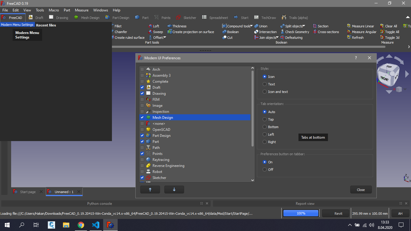

Hi everyone I ported Tabbar Preferences. You can close or open tabs. Other functions not working for now. Restart to see changes.
If you still interest I need a settings icon.

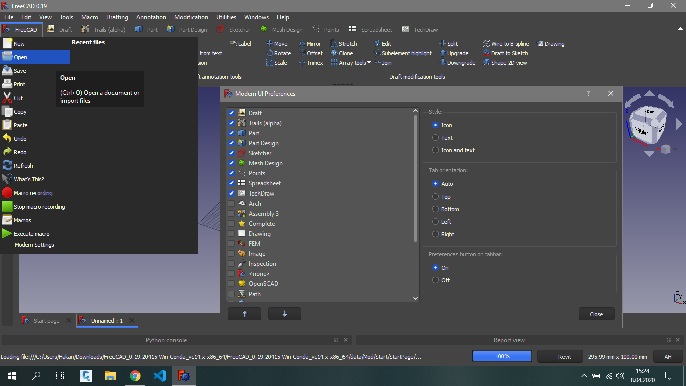

Added options to file menu.
Is it possible to show only icons (maybe user setting) or at least shortened texts? Shorten text to N symbols for example. This way it will be possible for all Sketcher tools to be visible in one screen and no need to scroll left/right.

Yes I will add an option to show only icons
Which one is better?
+1 for the first image
+1 for the first too
Okay. First one.

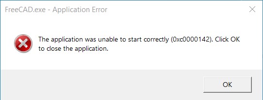

On Win, 20477 can’t start.
Just wondering if you could have a config file to decide which wb is not loaded at start. Or fc could do it by itself already. Some WBs you never use.
send error code.
I already added a setting for that. Click modern settings at the bottom.
I mean start freecad from console.
C:\FreeCAD_0.19.20477\bin>freecad
Nothing happend.
Nothing happend.
Try freecadcmd.exe at the same folder
