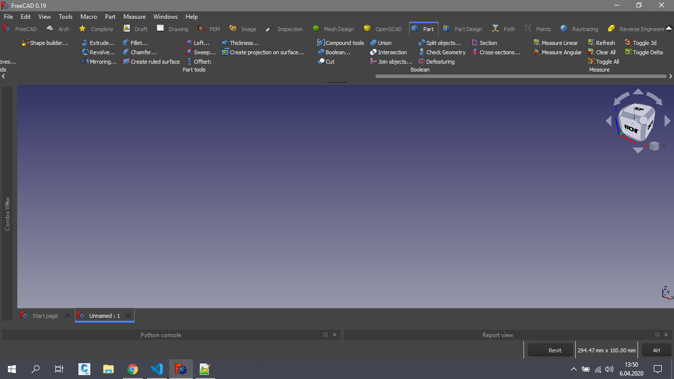

Honestly I don’t like FreeCAD default UI. So I started to look for alternatives. Firstly I created a macro for collapsible docks. You can find it here: https://forum.freecadweb.org/viewtopic.php?f=22&t=44659
After that I think “why I don’t do something for toolbar?” and I started to search for a solution and find this repository: https://github.com/RoadrunnerWMC/PyQtRibbon
Finally I created this UI and merge them at one place :slight_smile:

When you restarted you don’t see any toolbar.
Create a macro.
Paste this code in to macro.
from PySide2 import QtCore, QtGui, QtWidgets
mw = FreeCADGui.getMainWindow()
mw.menuBar().show()
WBList = FreeCADGui.listWorkbenches()
for WB in WBList:
    FreeCADGui.activateWorkbench(WB)
    for tb in mw.findChildren(QtWidgets.QToolBar):
        tb.show()
Execute it.
Restart FreeCAD.

Interesting, will every workbench be loaded at startup or when you click the corresponding tab? I think it would slow FreeCAD down if every workbench is loaded at once.
I really like the collapsible docks idea :slight_smile: will these features be available separately?
Workbenches are loading when you clicked tab :slight_smile: collapsible docks available as macro for now

Feature
When menu minimized if you click one tab it shows tools. If you click another area menu minimize itself.

Is there still a lag period opening workbenches that haven’t been invoked yet ?
If so, is there a ‘lazy loading’ strategy that could be used to auto-load (in the background) certain workbenches that a user is used to using?
I answered this question before :slight_smile: Its working like default UI. Workbench will be active when you select it.
