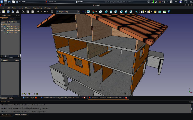

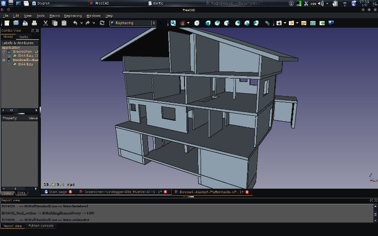

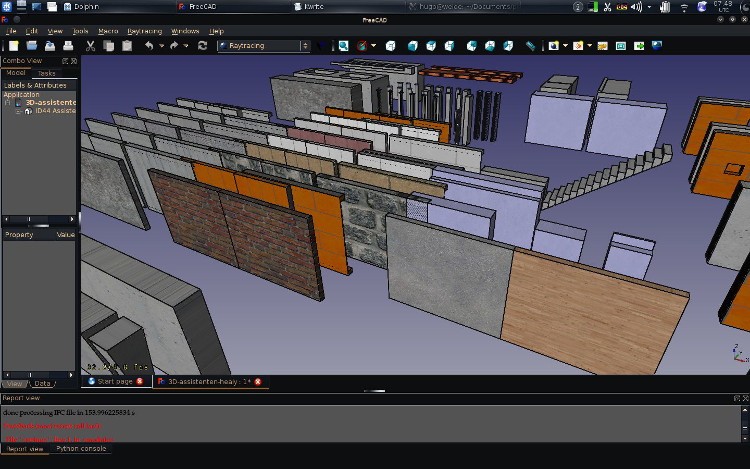

Found the Macro Texture Objects and tested with imported material from ifc-file. I could’nt helpt to post the screens. I still need to clean and post the code for importing materials and properties. :blush:
some problems left:
  • how to get rid of the textures without closing the file
  • scale of the textures (roof and bricks)
  • orientation (bricks sometimes going upwards)

To remove the texture I think you only need to delete the texture node (parentnode.removeChild(texturenode))
For the scaling and orientation, coin has all the tools to do proper texturing, but I never looked very far there… The default behaviour is that the texture size depends on the object, but look in Draft.py at line 2925, I had found a way there (used for Draft hatch patterns) to set a scale to a texture that doesn’t depend on the object, by using a SoTextureCoordiantePlane node. Maybe yuo can use the same system.

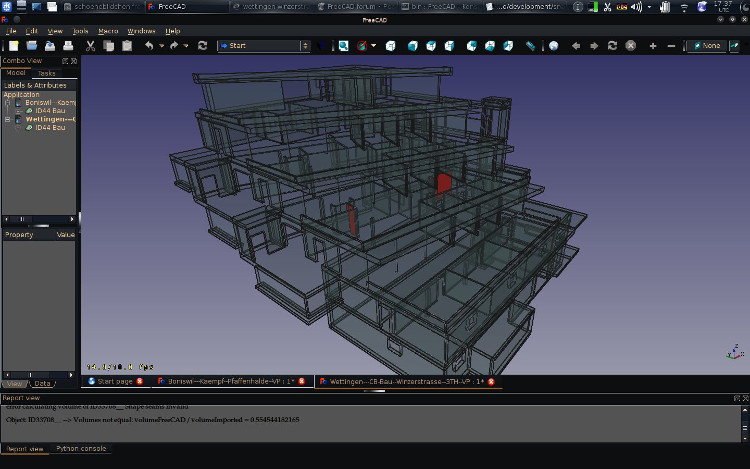

The volumeTest() is off inerest too. If the volume of FreeCAD is not equal the volume of IfcElementQuantity the element is coloured red. See attached sceen. FreeCAD nealy imports all my geometry. BTW found not only bugs FreeCAD but in Allplan using the volumeTest() to test the import in FreeCAD. :smiley:
