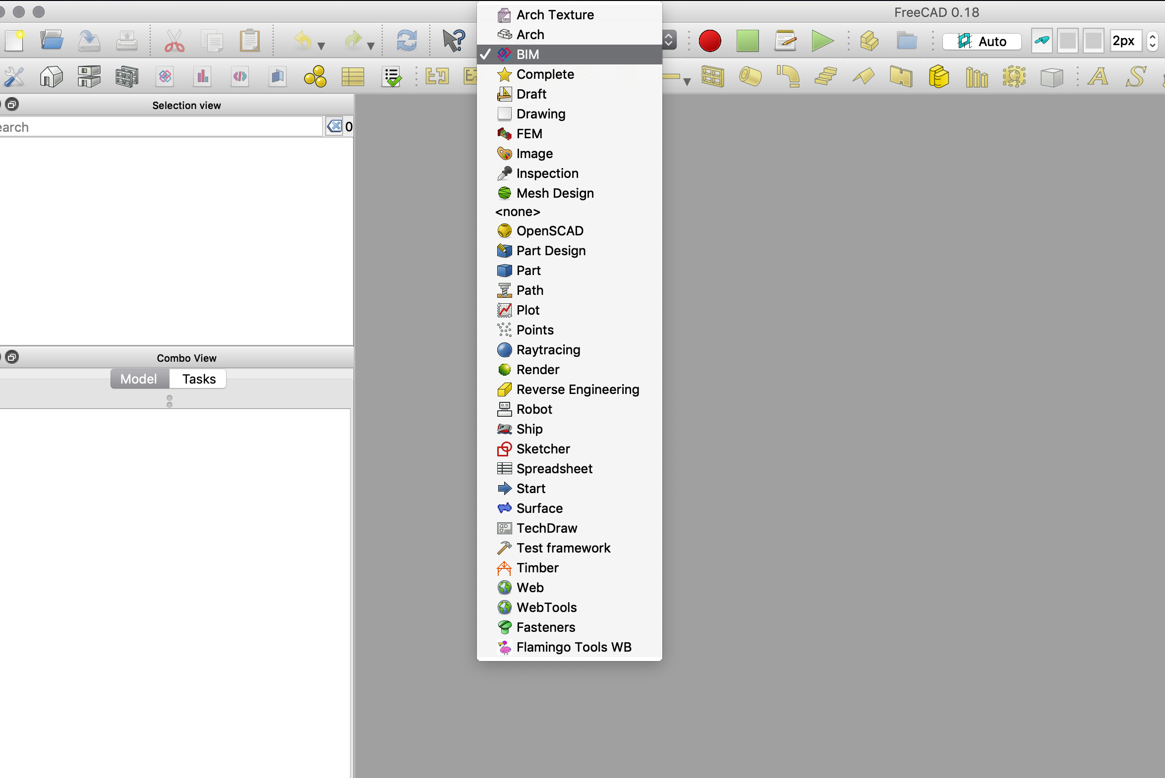

Meanwhile, I downloaded the last build from dropbox and it works. High resolution looks nice!
There is still an issue with Draft and Sketcher workbenches when you use scaled (retina) resolution: in the draft workbench you can’t get the handles (there is bug open for that) and in the sketcher bench, the selection rectangle is not located at the right position.
Same behaviour in 0.17.
QT supports the different resolution quite well, but it is not yet perfect: when you switch while the application is open. A simple relaunch fixes the toolbars.
Generally, the 3D viewport doesn’t like scaled resolutions on MacOS.

Another issue: is the Timber workbench working for yo?
Mine is broken. It works with 0.17.
Yes this problem is there. But despite the bright rectangular is way off the selection works.
it is not nice but workable. When releasing the mouse button you see the selection lines and dots are green.
Indeed it works. This is fine, but have you tried the draft workbench? You can’t select any node of an object. In that case, it is unusable.
My point was that scaled resolution is not properly supported/implemented in the 3D view currently.
