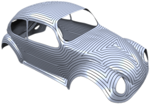

  • Pencil-milling. By looking at the cutter-contact point with a rounded tool (BallCutter or BullCutter) it is possible to determine the surface normal at the point where we make contact with the model. Pencil-milling cutter-locations are points on the STL model where this contact-normal changes abruptly. It should be straightforward to create a mesh in the XY-plane covering the whole model, then run drop-cutter on all vertices in the mesh, then find places where the cutter-normal changes abruptly. Optionally refine the mesh adaptively in interesting regions. Then hook up these found points into pencil-milling paths.
  • Constant-scallop. Again start with a mesh in the XY-plane covering the whole model. Run drop-cutter on this to project “wrap” the mesh down on the model. Refine adaptively to desired accuracy. Now run a “geodesic distance field” or similar (many papers/descriptions exist) algorithm on this mesh. This results in equally-spaced curves on the mesh, which at least with BallCutter will be exactly (or an approximation(?)) a constant-scallop toolpath. See for example this image: http://www.graphics.rwth-aachen.de/media/paper_images/vw_01_f3fcac076c1.png
  • non-simultaneous 4/5-axis paths are possible, i.e. toolpaths where we do not machine while the 4/5 axis rotates are essentially just 3-axis paths, but with the STL model oriented/rotated into a new position. Applying all existing 3-axis oprations to rotated STL-model should be straightforward.
