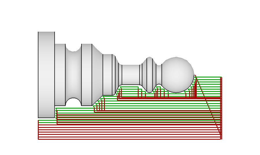

Roughing:

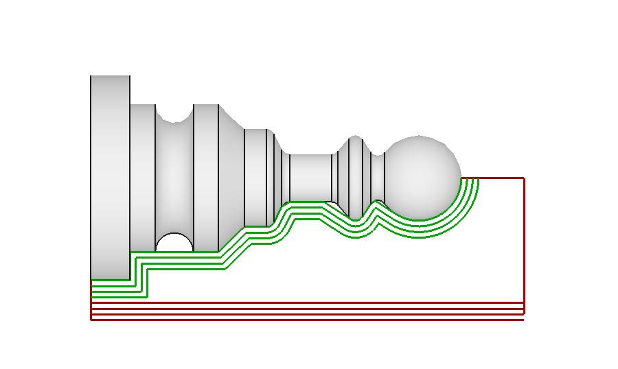

Profile:

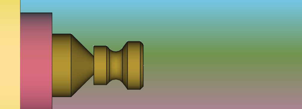

  6. Here is a simple example of a lathe style job model. For our purposes, it includes flat, ramped, and interior/exterior fillets. If we do not calculate clearances, but only idealized points, the tool paths generated will cause the Job model to be violated.
  7. Here is the sketch used to generate the model, and in construction lines, I show the Chuck–which must be cleared. I include it only for perspective because in the real world, it will be a significant consideration.

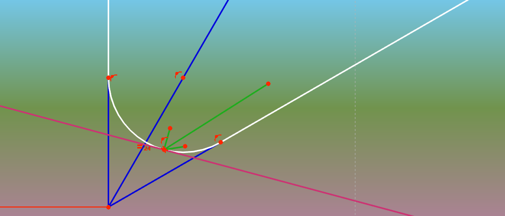

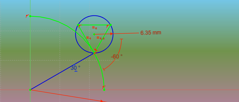

  3. I have drawn a Sketch of the example insert. It is aligned with the side cut at 0-degrees, which I believe is consistent with the style of shank linked above. Shown here, the nose-radius of the cutting tip of the insert is constrained, tangent to the “ramped” portion of the model.
  4. Here, I have zoomed in on that, and added an “arrow” pointing to the tangent point between the insert and the job model. This highlights the question–what is the reference point for the tool? For milling, the reference is the tip of the tool, which is always aligned to the center of the spindle. Even when shifting from Square-Mill to Ball-Mill, the reference remains the same, though the toolpath must be offset vertically compared to square mill because the center of the ball is tangent to the job model, where the square mill requires an offset along the XY portion of the normal at the point on the model. Here, for lathe tools, the center of the ball should again be offset along the normal to the point by the radius of the ball (0.4mm in this instance).
I believe–but am not sure–that here too, the center of the radius of the cutting point is the reference point for calculations–that means that the generated tool paths should depict where the center of the radius of the cutting point travels.
  1. Here, I show a path for this insert, that moves the center of the radius of the tool insert’s cutting corner. For this example, I drew it in Sketcher by hand. Note that I left space between the Chuck and the insert at that end. Note also that it is probably best to model the chuck–including jaws–as an axial/radial clearance. Where you want to move the cuts with precision, you want to avoid the obstacles with greater space, so modeling the chuck and jaws in detail is likely not helpful.
  2. Note too, that in this example, the insert is in practice able to travel along all points of the finish cut line not constrained by the chuck. This is not generally true though because there are exceptions including, though not exclusive to: internal model surface that cannot be reached by the selected tool, grooving of the external shape that are too sharp for the selected tool.

I am now part way through writing a Python Library (LibLathe) to handle all the complicated parts and supply gcode to the FreeCAD Gui. The library is designed to be portable therefore doesn’t rely on any external dependencies, including FreeCAD.
This work is mostly done with the basis of the offset and clipping algorithms mostly working with a few edge cases still left to resolve.
I have written this myself as other offsetting an clipping libraries are more aimed towards milling strategies and don’t work well for lathe tool paths; one example would be recognising grooves and undercuts and removing these from the tool path.
This is an example of the profiling op:
There is a lot of refinement required but I think most of the complicated parts are worked out, for example the next thing I’m working on is continuing the roughing passes down the profile to intersect with the previous roughing pass to ensure that material removal is consistent for each pass.
