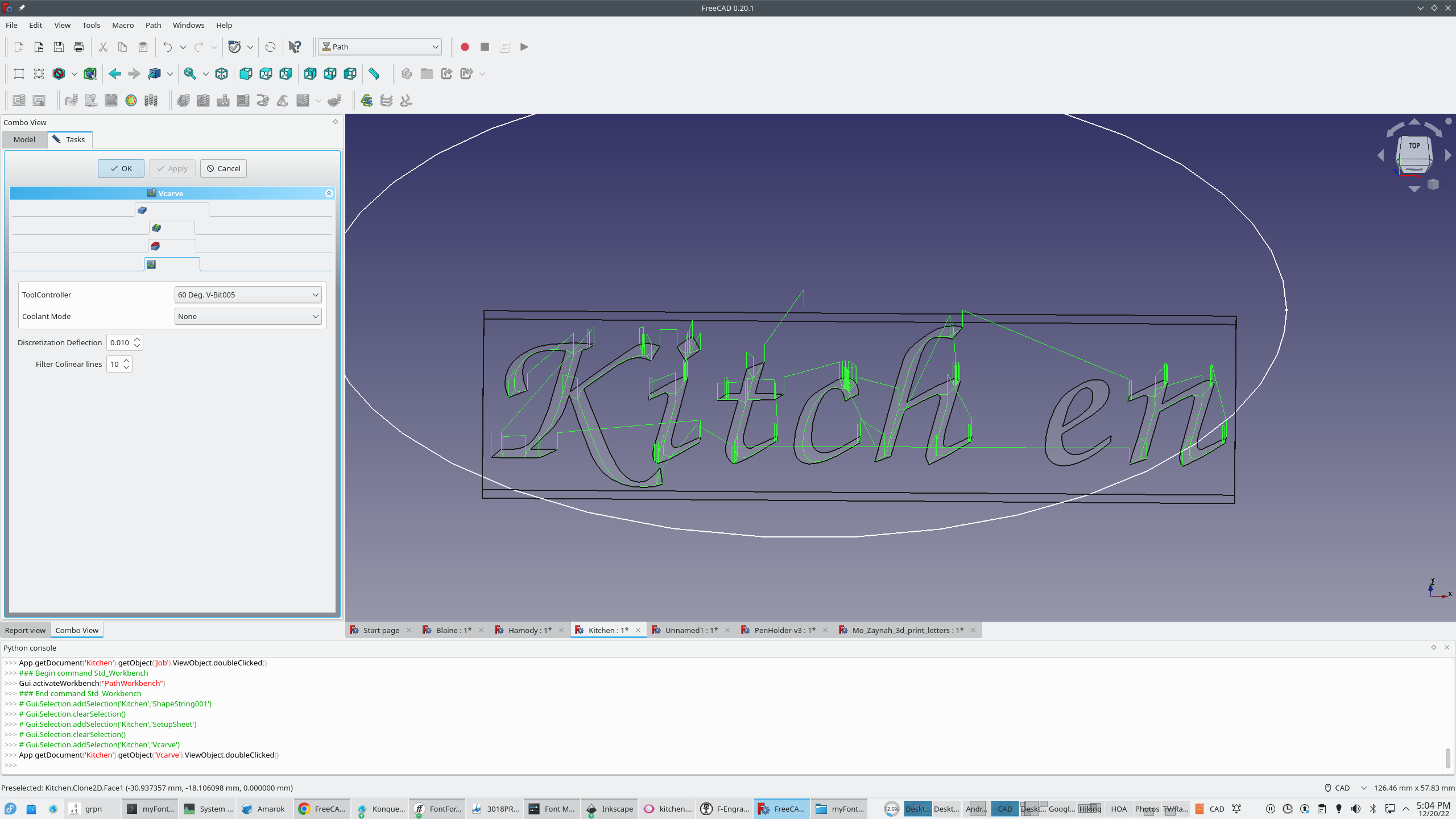

In the attached file, the letter “e” in Kitchen is not being v-carved, while the rest of the string is.
Kitchen.FCStd (59.6 KB)

The “e” is also the only letter there with an “island”. Not sure if that has any thing to do with it, but it might be an interesting test to modify the e so the loop didn’t fully close, or try other letters in its place, like p, a, d, b.
Obviously you don’t want a sign that says Kitchbn, but the test might reveal something.
Thanks for the suggestion. That had occured to me, but I had another word that had an “a” in it, same font, same size, and that rendered fine (I also replaced the “e” with an “a”, as you suggested, and that did create a path for it). That other word also contained a “B” and that also rendered OK, but the same word, in a slightly different font did not create a path, though the other letters did. I tried other fonts and they seemed to work. I do believe this is a bug.
Can you use a program like FontForge to check if the font has a problem? There are many fonts out there having issues. I rather assume a problem from that side.
I played with this for a while. It seems that the problem is the “e” is too close to the “h”. If I added a space before the “e” the V-carve worked fine.
It also works if the font is bigger.
I do not know if this is a bug or some basic limitation.

When I replace in the e the B-splines with arcs, i get some sort of a result. Alas, at the right upper corner I see very fancy paths. I tried increasing the tool diameter, but didn’t succeed.
Kitchen_cb.FCStd (33 KB)
I have opened the font with FontForge; I don’t see any indication of a problem. I have also tried a different program for V-carving, F-Engrave; It has no problem generating a V-carve path, but the inter-character spacing it generates is quite a bit larger than what FreeCAD generates.

Hmmm. I tried adding a space before the “e”, but still does not work for me.
Interestingly when I try it the ‘e’ gets carved but the ‘h’ is missing. From what I can tell is somehow the voronoi algorithm discards all edges as being “exterior”, which means infinite in length.
