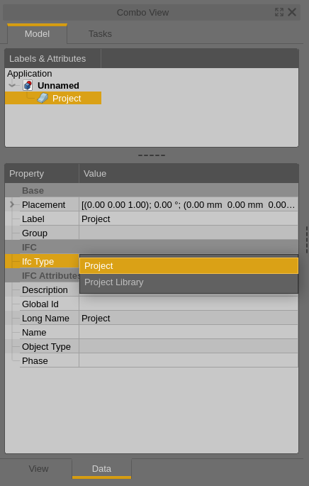

Right now, I’ve merely duplicated the function of an IfcSite element, which can contain (er, group?) other things. Here’s an example below. It still uses the IfcSite icon for now.
I wonder if there is any need to create entities for things like IfcRelAggregates and IfcRelContainedInSpatialStructure. Or perhaps those types of relationships should be invisible to the user? Thinking out loud … I don’t personally see a benefit.
In addition I’m experimenting with exposing all inherited attributes up to IfcRoot instead of stopping at IfcProduct. Previously the JSON stopped at IfcProduct so there were certain attributes which were locked. Now, as shown in the IfcWall below, there is the full gamut of attributes. It still needs more intelligent behaviour, such as for the global ID as an obvious example, and it does indeed give opportunity for the user to break things, or maybe use GUIDs creatively such as linking other IFC files.
Note that the GUID is already stored in IfcData. Not sure if it’s really useful to have it visible there. Will someone really want to change a GUID manually?
Also, certain of these would be redundant, for ex. Name. And having “Object Type” there might confuse people more than it helps, I fail to see its use, actually… If you think of it, IFC objects have name, long name, description, all simple user-settable strings… I’ve never seen used more than two of these.

WIP update: there seem to be 4 main types of rooted ifc objects: Products (i.e. those with geometric representation - maybe spatial containers can be a sub category of products?), Contexts (projects, libraries), Object Types (FreeCAD doesn’t support this currently, but something we should figure out), and relations (super overengineered by bS, which ideally we should hide and automate as much as possible).
I’ve done a bit of refactoring. Now arch components implement products, and you can change them to any other ifc product - however you cannot change an ifc product subclass to an ifc context subclass. This makes sense - you cannot change an IfcWall to an IfcProject, because the latter has no representation.
The project element now knows that it is an “IfcContext”, and you can switch it to any other IfcContext (for now, only between project and project library). Similarly, you cannot change an IfcContext into an IfcProduct subclass. It also sets up simple attributes now. (Note that coordinates are not a simple attribute, so it’ll be implemented differently).
Seems cool so far! We need an icon :slight_smile: Not sure how a project icon should look like…
They are, at the moment, no? I like the idea that a BuildingPart can be either a spatial container or a product itself, so in the future we can use BuildingParts more and more as a kind of assembly object, or “reusable component”. This is something not very well defined in IFC…

You will notice:
  • You can set all attributes of the IfcProject
  • There is a map conversion and target CRS linked to the main geometric representation
  • The main geometric representation is now a ‘Model’, which has a sub geometric representation of a .MODEL_VIEW., this is what objects are linked to (see #38 which links to #22)
If you choose not to create an IfcProject element, it will generate one for you as per the old behaviour of FreeCAD. This generated IfcProject will not contain any map conversion like the old behaviour. However, it will have the proper subrepresentation.
