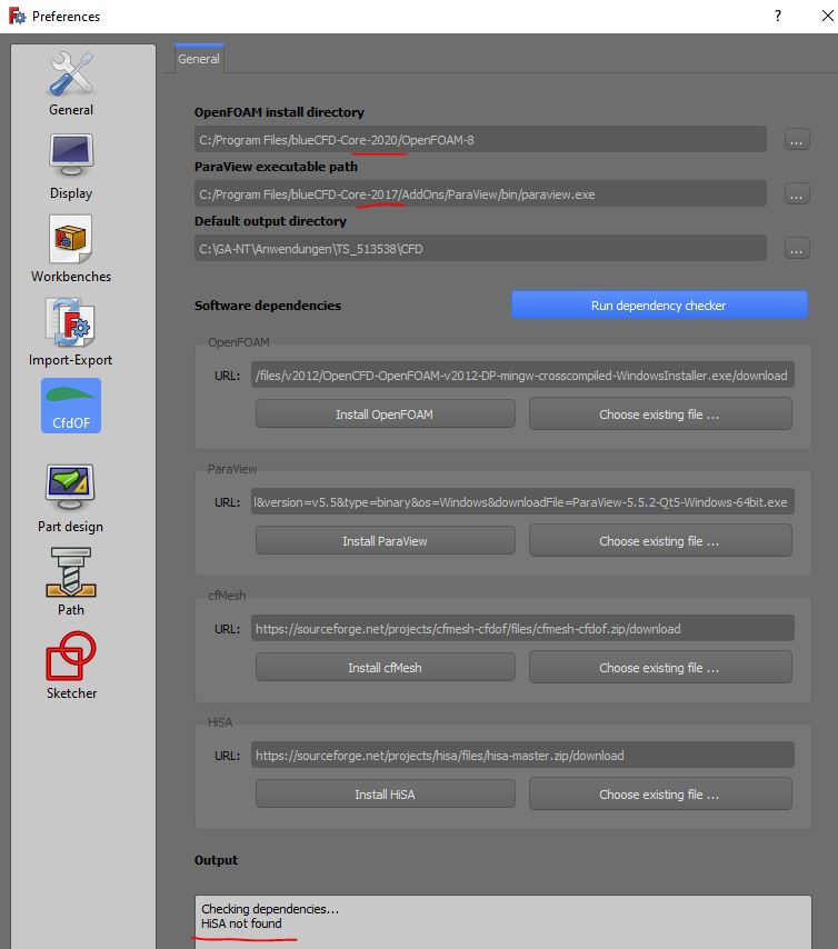

OK, bluecfd 2020 works.
Paraview: set path to existing exe in bluecfd 2017.
cfmesh: new installation for OF-8, works
Hisa (newest version from sourceforge): new installation for OF-8, but not detected.
Freecad:
Version: 0.19.24267 (Git)
Hash: b2ca86d8d72b636011a73394bf9bcdedb3b109b7
Python version: 3.6.8
Qt version: 5.12.1
HiSA has now been updated.
Installed HiSA 1.4.5, works with bluecfd 2020 and OF-8.

I had a thing whereas I didn’t notice that there BOTH file selectors for the .exe, below–AND–folder choosers above. For some reason, I had not noticed the file choosers above. Well, as long as BlueCFD seems to be found.
