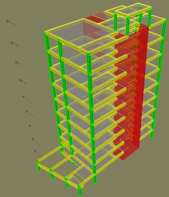

Yes, I also think FreeCAD is Very Slow in large models. I have been write a WB and I mport my structure model into FreeCAD. beside that, it takes a long time to import, it is very slow in basic operation like change view or select object.
my ETABS model:
imported model to FreeCAD (function) :
another model:

Excuse me, maybe I am wrong. I don’t want to send Ifc file to etabs, because this way, I have lost many features in my model, like loads and etc. . I want to Import my model from etabs into freecad (with my importer) and then apply some change on it ( in this step freecad is very slow), and then export it to etabs (with my exporter).

my model is consist of 120000 area object and frames and My freecad file has about 17 Mb in size. although, it is slow in ETABS software, But in FreeCAD it is very slow that can be work with it
