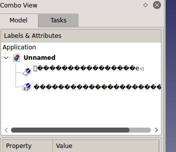

This is what I got:
>>> importIFC.open("wall.ifc")
Importing IFC objects......
����������������򀁇􀁷􀁳񀁵��������򠁇󙖠翈񭋐翈��������
  File "<stdin>", line 1, in <module>
  File "/usr/lib/freecad-daily/Mod/Arch/importIFC.py", line 373, in open
    doc = insert(filename,doc.Name,skip,only,root)
  File "/usr/lib/freecad-daily/Mod/Arch/importIFC.py", line 849, in insert
    a["IfcUID"] = str(guid)
UnicodeEncodeError: 'ascii' codec can't encode characters in position 0-10: ordinal not in range(128)
I don’t think it’s normal…
What was it supposed to be?
Thanks for testing. Indeed this is not normal at all…
Each IFC object has a guid which is a unique text that identifies the object and looks like: 2Hm9JvZjohDNSD2kdxZI3b
It should only contain latin letters or numbers.
If you open the ifc file with a text editor, you’ll see that some entities have one, for ex:
#94= IFCRELDEFINESBYPROPERTIES('2Hm9JvZjohDNSD2kdxZI3b',#25,$,$,(#74),#89);

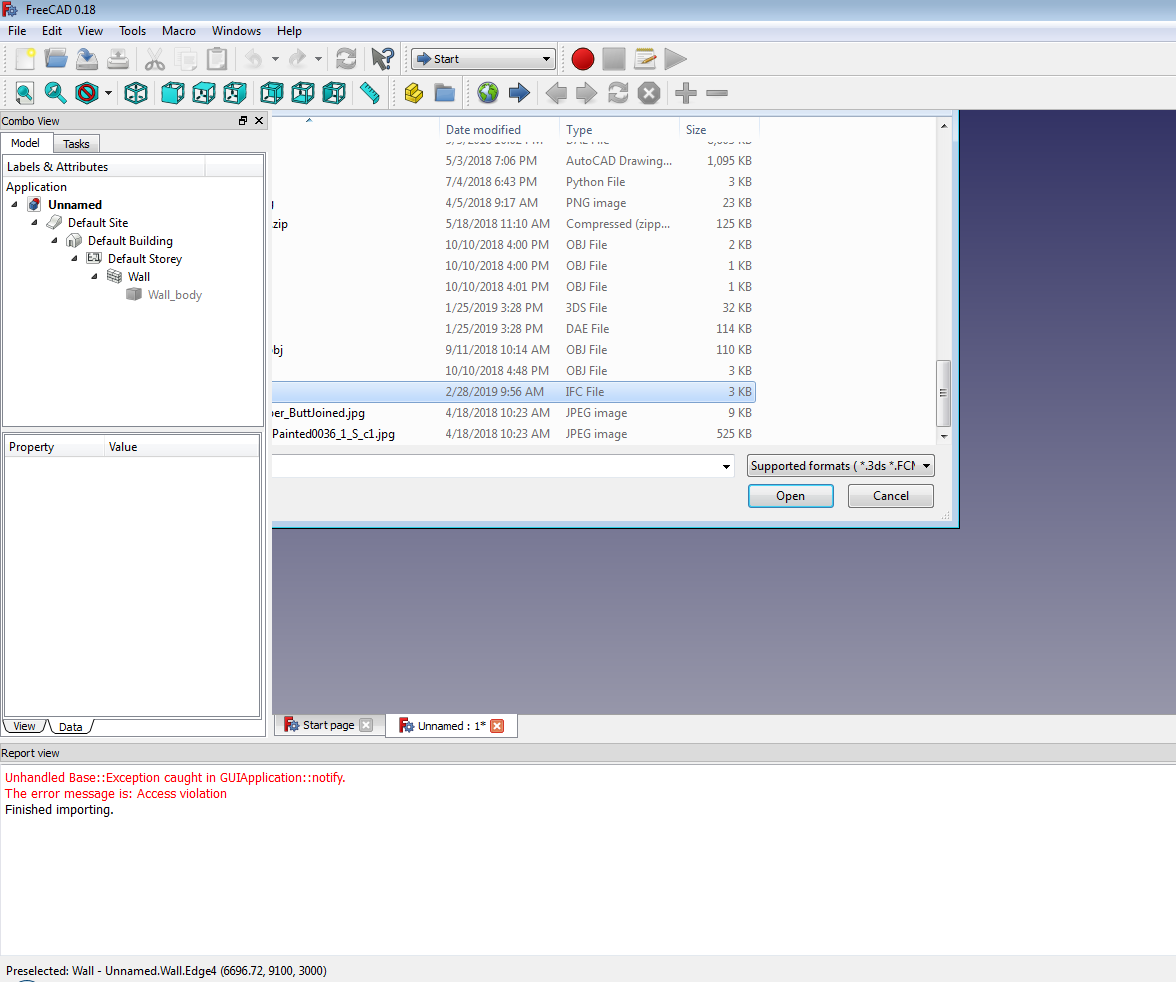

HI,
some updates about the issue:
I tried to import an IFC file in a Windows 7 machine. Actually I tried on two machine, a physical one and a virtual one (the last is hosted on Virtual box by one of the two Ubuntu machine I unsuccessfully used until now).
The FreeCAD version I used is the same (0.18.15969) but the result is very different:
  • on the physical machine I had no problem at all: the IFC file has been perfectly imported
  • on the virtual one the object seems correctly imported but as soon as the software load the data the GUI freezes (see the screenshot attached) and force me to kill the application. The console return this message:
Unhandled Base::Exception caught in GUIApplication::notify.
The error message is: Access violation
Finished importing.
This are the specs for both machines (on the virtual machine I installed the image of the same Windows version):
OS: Windows 7
Version: 0.18.15969 (Git)
Hash: 4765b7e2fe6d3609e9fbf3e3eb6648d7af1dd526
Python version: 2.7.14
Qt version: 4.8.7
OCC version: 7.2.0
Some suggestion about what to try next?
The last issue is because of bad OpenGL support on virtualbox… IIRC there is an experimental option somewhere to enable 3D inside the VM, but I have never tested…
Still don’t know what might be causing your first issue. It’s really weird
