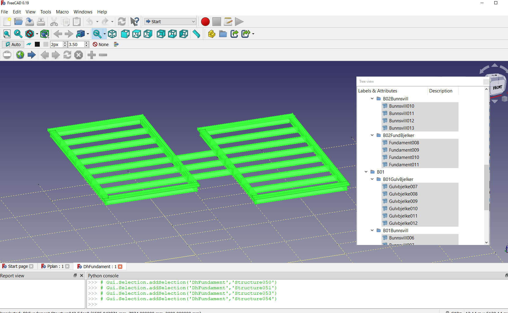

Probably something Basic I do wrong?
When Exporting to IFC, objects ‘Jump’
Imported in Blender (BlenderBim) (same result in other ifc viewers:
Freecad File attached
DhFundament.FCStd (152 KB)

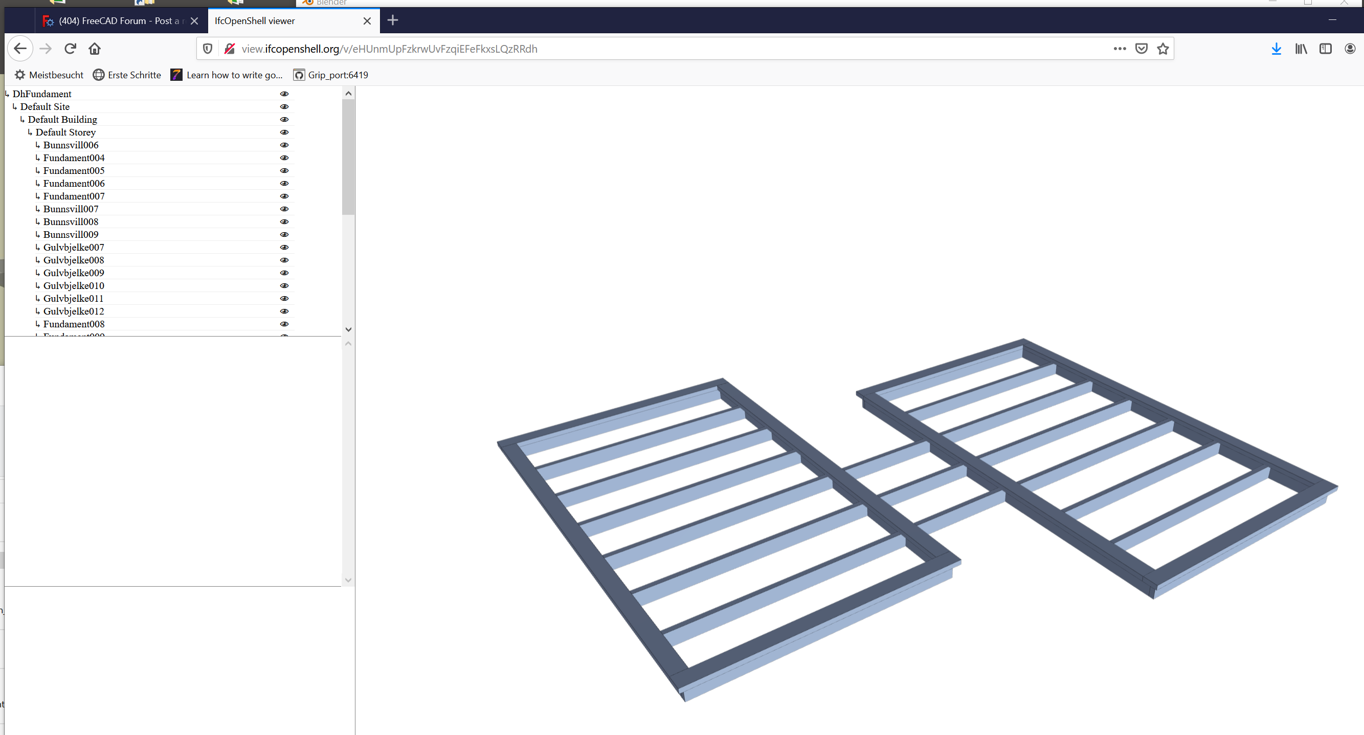

for me it seams to be a viewerproblem …
ifc exported from the file provided in the first post …
only blender does not show the objects.
screens follow …
DhFundament.ifc (40.3 KB)
