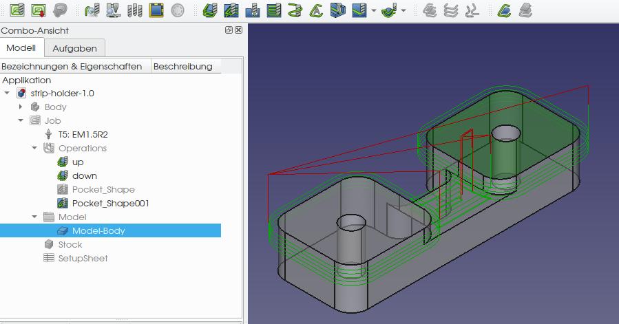

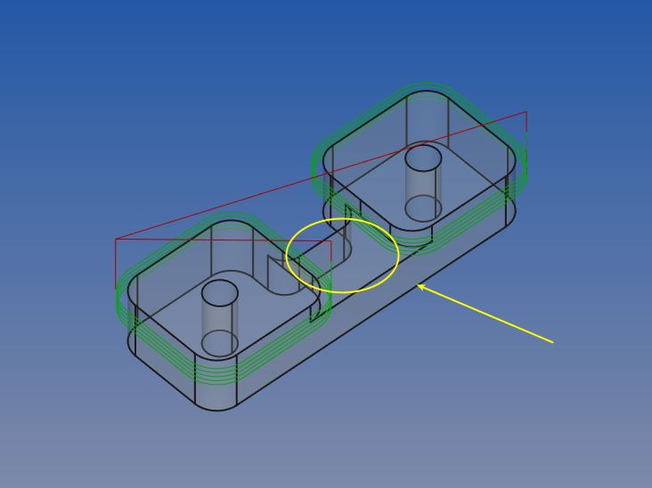

Hi folks,
how can I nicely mill the area between the two bulges in the image below?
The “mill pocket” tool is restricted to the surface, so the borders are not well machined… even by using the “Extensions” the result is a mess. :cry:
Any idea?

That’s a challenging face to mill.
You could try using a slot operation down the centerline to open it up. That along with your profiles and a final profile of the whole shape should get everything.
How you obtained that milling path in the center? :confused:

Found!
By selecting an edge and then by making a perpendicular slot.
But… then? How I move further from this? My milling bit has just a diameter of 1.5 mm. So it cannot be used to machine the space between the two bulges in one pass.
Hi Giulio,
why you don’t use Pocket or Adaptive?
First milling the pocket, secound the contour removes the corners wich Pocket Op lefts…

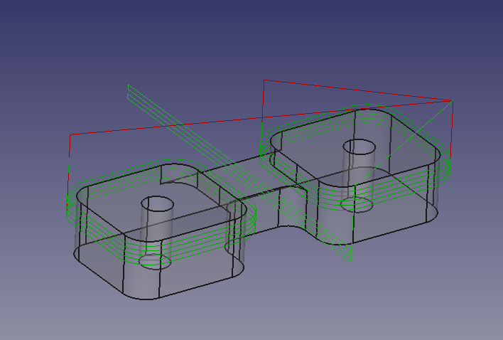

Afternoon Sir,
As @Herbk suggests, you can use the Pocket op alone, or I did a scenario with a combination Pocket and Slot operations in the attached file and images.

Thanks for the ideas!
Anyway, I solved by setting the opportune “extensions” in the pocket-operation.
Yeah, there is still a lot of time lost in travelling, but is the thing more close to what I was looking for:
Here below, the “Extension” of 2 mm applied only to strategic edges (violet color):
Fanstastic case study and solutions proposed. I would have used Adaptive on the problematic face followed by Deburring on the remaining edges.
Yes a straight toolbit is not ideal for a Deburring OP, but I perceive Deburring more as a “path along edge” tool.
