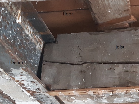

Let’s say we have an oak joist (15 cm x 15 cm x 370 cm), which is “fitted” in the profile of an I-profile beam (height 140 mm, width 66 mm), and the surface where the joist is laid is too small.
Among many possible solutions, I would like to study the right dimensions for the following blue metallic part:

Here you can see there is already a wooden floor above (Nota: the joists look old, but they are still very strong and hard oak):
See pics.

In your photo it looks like that the steel beam isnt a 140x66 mm I-Profile,
but 2x U-profile with something in between. Is that right? Dimensions?
Looks like that the I-beam is tilted against the wooden beam.
There are two 140x66 mm I-Profile (I can confirm this), and (I think) concrete in the middle.
One of the two is tilted indeed, but I think it is like this since ~80 or 100 years, I think it has been installed like this.
