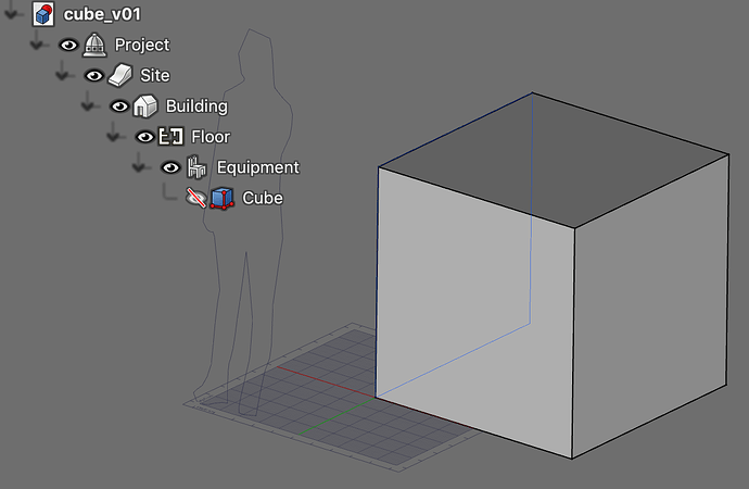

This is my cube test:
cube_v01.FCStd (23.3 KB)
Thanks
I am able to export the Site in your file after entering a value for the Address property and the Postal Code property.

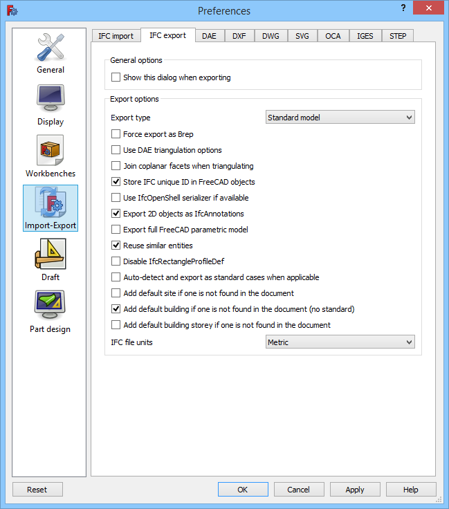

Do you have any special setup in Preferences/Import-Export/IFC export panel?

Just random input.
Yes.
See image.
cube_v01_roy.FCStd (21.6 KB)
Error persists here with your file and same exporting Preferences as you…
