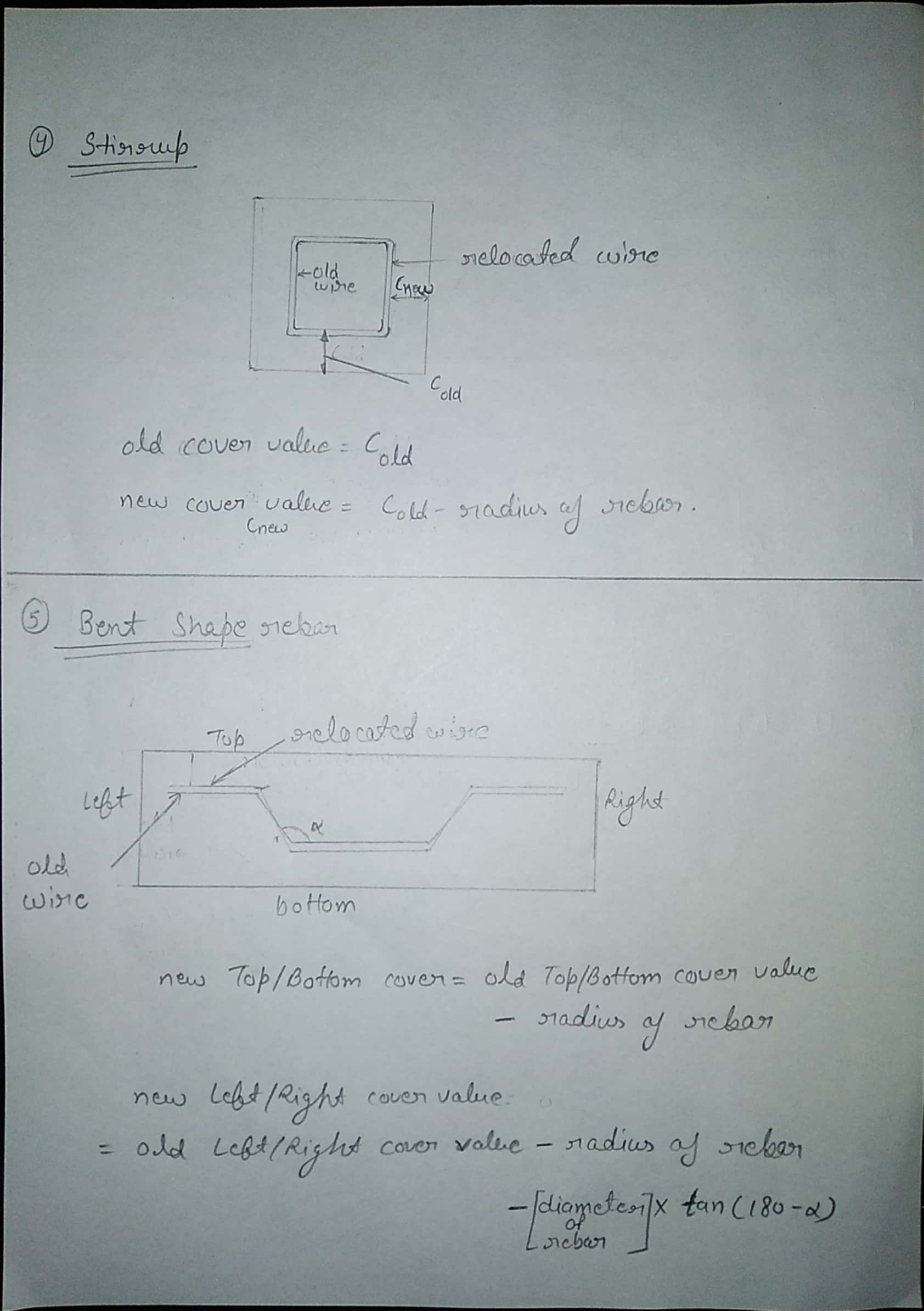

Hi @all,
I am working on the issue: https://github.com/amrit3701/FreeCAD-Reinforcement/issues/91
the previous discussion on the issue is here: https://forum.freecadweb.org/viewtopic.php?p=426285#p426285
To calculate rebar sharp edges length using outside relocated lines instead of the centre line in rebar shape cut list.
I am planning to get the appropriate length as follows.
In getRebarShapeSVG function of RebarShapeCutListfunc.py :-
  1. Based on rebar type and its orientation, calculate the new top/bottom/right/left cover’s value to adjust rebar length in the rebar shape cut list.
  2. Get relocated points by calling the getpointOf function, with new cover value, based on rebar type.
  3. update basewire based on relocated points.
  4. use this update basewire to create an SVG of rebar.
I am thinking to calculate the new cover value as shown in the attached images.
Am I on right track?
Any suggestion will be highly appreciated. :slight_smile:
