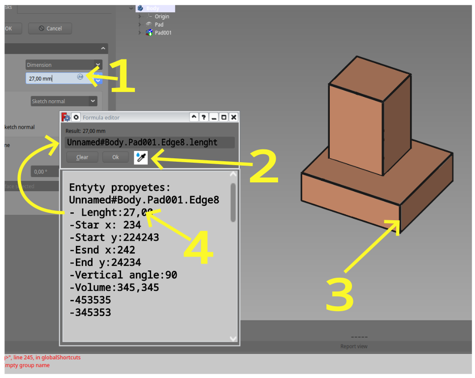

Formula editor improvement.
A mockup with the process to “catch” a length propriety of an edge with a pick tool.
For maximum flexibility, the reference can ve anything that you can extract a number to assign to an expression to make a formula.
The “another level feature” are make an: if, or, … basic programming code formulas in the formula editor.
expressions using generated geometry are a terrible idea, in any case it can allow clicking a property or referencing the whole object

Ok I understand it is caused for the TNP problem, and the use of spreadsheed is recomended way.
In the example I use generated geometry, but you can pick a more stable propiety like a constraint lenght on sketch or pad lenght.
