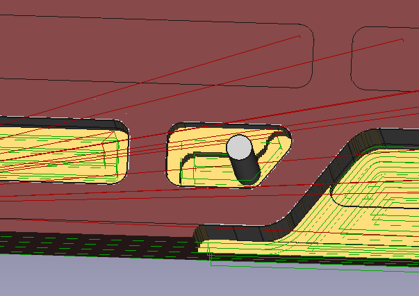

I had succesfully design this solid with pockets and generated the toolpath. I think it will work just fine, however I am a little bit confused with what is just a simulation and how the tool will move on the cnc in real world. And I have two questions:
  1. The thing is that I have pockets with the same depth. Is there a way how to make a operation of two pockets with the same depth in single operation (two on the odge) and then combine them with another two pockets (two smaller next to them) while moving the tool from lower left pocket (1 - 8cm wide), then to move to next (2 - 4 cm wide but with another depth), then trird with another depth etc while not to return the spindle to the starting point 0,0? I found that best strategy is to create an operation of every single pocket separately in order to stay efficient, but I am wondering if there is some quicker solution..
  2. If I have created the pockets separately in good order - from lower left to lower right and then upper right to upper left, can I somehow enable the boolean “mintravel” of all operations “in the group”, so it will clear one pocket and move to another while not coming back to start point 0,0?
  3. On the picture 2 I can see that the step is executed just by moving Z axes by the set distance, is there I way how to set that it will move slowely while cutting the wood? This is happening in every step down in all operations. I think that if the endmill will make a step down on some angle, it will be better for life of that endmill and result in better surface.
and lastly 4) Is there some way to make finish passes of maybe 0,5 mm inside the pockets and outside actual workpiece?
I found a video from creater of CAM module on this forum https://www.youtube.com/watch?time_continue=1&v=k1ezXIaOw60&feature=emb_logo&ab_channel=sliptonic, but I think that this is not the solution whoch I want. I think I understand the start point but my starting point of the actual job is right, so I don’t need to change that manually.
In the video there is mentioned MinTravel boolean, so I am wondering If I can fuse that somehow.

Here’s a shorter one. Don’t get hung up on those phoney red lines, the truth is in the posted code. Learning to read the code is a good thing but until that time maybe an online back plotter ? https://ncviewer.com/
When setting up a job in PATH make Z=0 the top. Making the bottom of the part Z0 is usually a bad plan.

the movement is only relative, in G-Code if using the G91 modal, which means incremental machining. if using G90 instead then the machining coordinates are all absolute vs. the origin you selected placed virtually. Usually in the real-world that would be G54 by default. G54 to G59 are called Work Coordinate Systems or Workpiece Coordinate Systems or some variation thereof. There is a plethora of simple GCode explanation of how that works.
I agree with above poster, the best way to check the real instructions your machine will receive before crashing a spindle, is to copy paste your code in NCViewer https://ncviewer.com/. Alternatively, some users use https://camotics.org/

People are often confused about Path rendering the backplot twice; once as the operation and again as part of the job. This is why you have to toggle the visibility of both the operations AND the job to hide everything. This is intentional and a feature. When you’re setting up an operation, you’re concerned with the path accuracy of that alone. But when you’re configuring the entire job, you care about the order of things and how it all fits together. Each operation in a Path job is atomic. Each calculates its path commands independently. This means you can hide everything except the one operation or show it all. It also means the entire job doesn’t have to be recalculated if something changes in an operation.
If you want to see a more accurate view of the job overview without the redundant red lines, just hide the operations and only show the job.
Even then, despite our best effort, it’s impossible to completely render how a job will look an your actual machine. This is because the job might be outputting gcode for multiple coordinate systems and the relative positions of the those WCS are not know to Path. They only exist in the controller.
Running through a simulator, and or ‘air-cutting’ is the best way to check your gcode.
I agree with above poster, the best way to check the real instructions your machine will receive before crashing a spindle, is to copy paste your code in NCViewer > https://ncviewer.com/> . Alternatively, some users use > https://camotics.org/

In your first image, I believe the line you circled in highlighter is the move from X0,Y0,Z0 to the first location in the GCode. It’s not possible for the drawing code to know where your machine will be when you start the program, so, it just assumes it is at 0,0,0 before you start. The only real alternative would be to not draw anything until all axis have moved to a known value, then start drawing. But it’s useful to know what the first couple of moves will be.
This is one reason that setting Z=0 to the top of the part can be useful.

#3 - Look in the Path menu at the Dressups. I believe are looking for the RampEntry dressup. That’ll ramp the bit into the workpiece.
#4 - Duplicate the path, make the first one leave some amount of stock (Stock To Leave), and the second copy will serve as your finishing pass… Though I think some of the operations have a finishing pass option built in (adaptive seems too… though I haven’t yet tried it on a machine)
