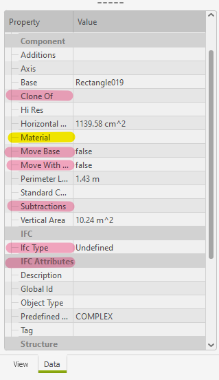

Hello everyone who is in this cool community, I have a few features to request that I think to make a great enhancement to Freecad.
It would be great for the “Make Compound of Several Shapes” to have at least the “material” property option. Highlighted in Yellow, but if possible to have the other options in pink aswell.
https://wiki.freecadweb.org/Part_Compound
This is useful when organizing the project for documentation to group objects and assign the grouped(combined) objects a specific manterial that can apply to all the objects inside that group. Currently the combine object only has a base option
