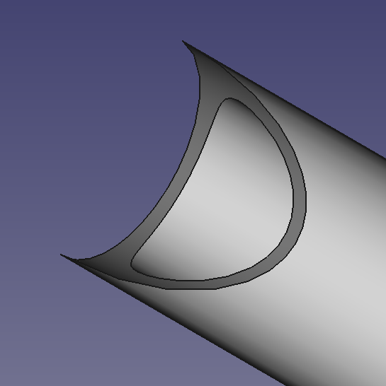

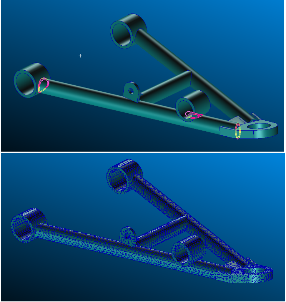

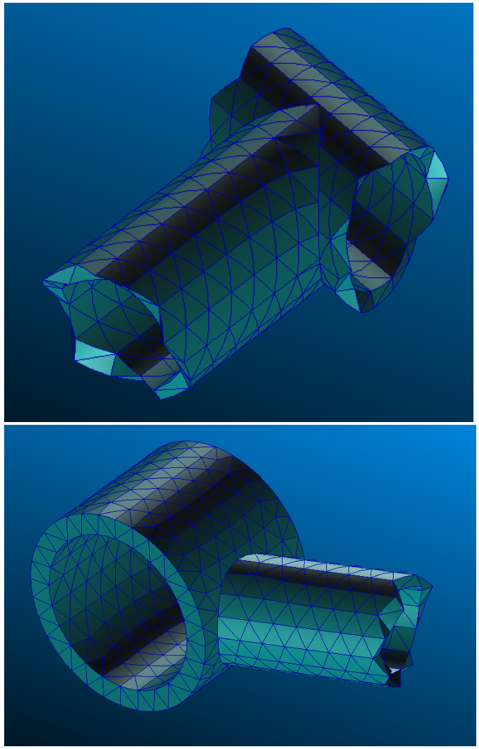

I want to run some finite element analysis on it, but at present when I run GMSH it meshes most of the structure but misses two tubes out when the file is imported with STEP Compound Merge enabled. If I run Netgen then I get a beautiful mesh over the whole component…that is only a surface mesh with no tetrahedrals in it.

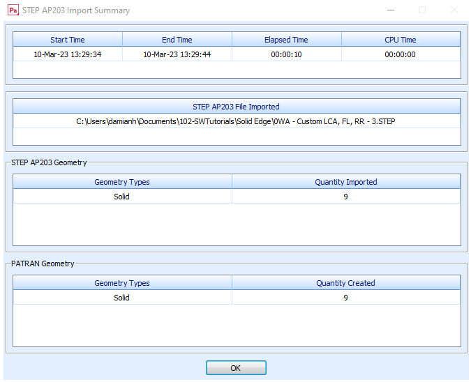

If I import the file without STEP Compound Merge then I can mesh each part individually using GMSH without difficulty, but the problematic items from the first go only have a surface mesh on them.
Anyone got any advice on what features of the CAD cause the mesher to fail like this? It’s basically a tube with an end cut made by another tube, the two that are failing; another tube in the fabrication meshes just fine.
After I have it all meshed, I will be back with more questions about “constraint tie”, I am sure.

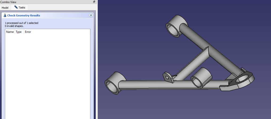

Without the CAD file that’s not so easy to help.
I assume the issue is due to your model which is certainly a mix of shells and solids.
You have to Part_CheckGeometry your model first.
Then adjust it to get only 1 shell or only 1 solid to mesh.
FEM workbench doesn’t handle multi-mesh.
Moved to FEM forum.
So my next question is how to run the geometry check?
https://wiki.freecad.org/Part_CheckGeometry - got it.
“1 processed out of 1 selected
0 invalid shapes.”
The file is attached.

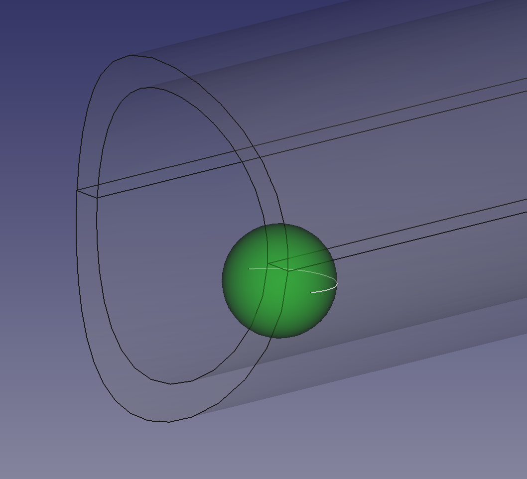

So a simple admonishment about mixing shells and surfaces doesn’t seem to cut it.
If I pick one of the problem items I can ask to convert it to a solid, in case it isn’t already. I get this message:
15:04:50  ArmSample is ignored because it is already a solid.
So then I ask GMSH to mesh it “from shape” with min element size 1.0 and max element size 4.0:
15:05:26  Fem::FemMeshObjectPython: Link(s) to object(s) 'Part__Feature' go out of the allowed scope 'FEMMeshGmsh009'. Instead, the linked object(s) reside within 'ArmSample'.
15:05:37    ElementDimension: 3
15:05:37    No Group meshing for analysis.
15:05:37    C:\Users\damia\AppData\Local\Temp\fcfem_ui9ap36g\Part__Feature_Geometry.brep
15:05:37    C:\Users\damia\AppData\Local\Temp\fcfem_ui9ap36g\Part__Feature_Mesh.unv
15:05:37    C:\Users\damia\AppData\Local\Temp\fcfem_ui9ap36g\shape2mesh.geo
15:05:37    C:/CL34-win64/bin/gmsh-2.7.0-Windows/gmsh.exe
15:05:37    New mesh was added to the mesh object.
15:05:37  Gmsh had warnings ...
15:05:37  Error   : Unknown number option 'General.NativeFileChooser'
Error   : Unknown number option 'Mesh.MeshSizeMin'
Error   : Unknown number option 'Mesh.MeshSizeMax'
Error   : Unknown number option 'General.NumThreads'
Error   : Unknown number option 'Mesh.MeshSizeFromCurvature'
Error   : Self intersecting surface mesh, computing intersections (this could take a while)
Error   : Could not open file 'intersect.pos'
Error   : ------------------------------
Error   : Mesh generation error summary
Error   :     0 warnings
Error   :     2 errors
Error   : Check the full log for details

So it seems the key line is:
Now, the real question is “what checks (other than the Part_CheckGeometry I’ve already run and found inconclusive) do I need to run to get ahead of this?”
OK, so when I get down to it, it becomes somewhat obvious:
Or here if the link is broken.
When two tubes of the same size are coped together, a sliver is the outcome, mathematically.
So that’s the sort of thing I need to be looking for.

The results from your check are very different to the results that I got.
Can you be more explicit on how you are running the check? Because I am seeing this:
Or this if the link is broken.
If you look at the picture, I think my confusion is reasonable.

I can go and find the .BREP file written out and passed to GMSH, and the specific shape2mesh.geo file for that tube. The “Report View” pane (bottom left on my screen) gives me the temporary folder name in AppData where the files are stored.
Running GMSH standalone produces the same error messages as in report view, including the rather cryptic “check full log for details”. No other log is actually evident to me. At the command prompt, GMSH reports 6 pairs of intersecting “facets”, all of which appear to be facet #8 and facet #3 at triangles 904, 12, 6844 and 9903, 9884, 904. To my untrained eye it looks like the same thing detected six times.
A file called intersect.pos is produced which contains four (not six) sets of co-ordinates, all of which are within a couple of millimetres of each other. If I go and look at the CAD data at that location (marked with the ball in the screen grab), it’s really not looking like a clear and present danger to the fabric of society.
Or here if the link is broken Why are my links always broken, by the way? The images display fine if I paste the URL into a browser.
It’s clear when I look at the surface mesher that it has got its knickers in a twist in this area, with all sorts of sliver elements that are clearly foxing itself. It’s really not clear to me why it would do that, specifically. Especially since on a nearby tube which is pretty much identical in this area, that tube meshes just fine.

It’s also clear that if I offer the same information to Patran 2021 - which is available to me for educational purposes, but not for officially completing this activity - that Patran identifies the original file as containing 9 solids and nothing else:
The geometry reads in cleanly and meshes cleanly:
In the problem areas, with some sensible mesh parameters, it manages very sensibly:
What conclusions am I to draw from this? Difficult to say. But it’s surely hard to argue that the originating data is flawed. Much more likely that I am making errors in a tool unfamiliar to me. Which is why I am here.
