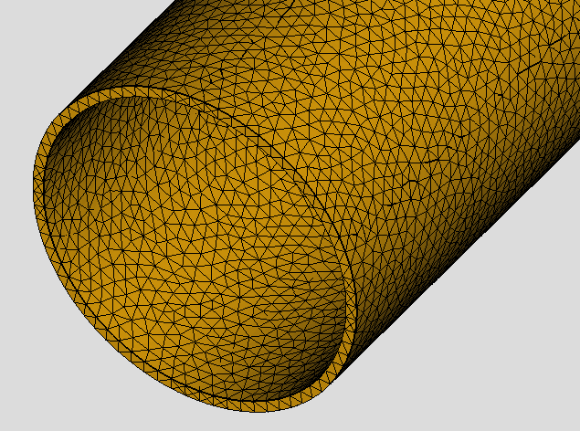

I made a tube from a sketch with two circles radius 53,55mm and 57,15mm. Then a Pad with length 744,98mm.
I switch Workspace to FEM mark the tube and click the Gmsh Icon and execute Gmesh.
Now I dont see a finished mesh and get the following output:
  • 0.0: We are going to start …
    0.0: Start Gmsh …
    0.5: Gmsh had warnings …
    0.5: double free or corruption (fasttop)
    0.5: Gmsh done!
I cancel Gmsh and change the length of the Pad to 300mm and repeat Gmsh execution.

Would you post the geometry you have problems with and would you post the version number of gmsh?
I just repoduced the problem to make a screenshot. With the beginning length of 744,98mm the Gmsh execution took 0 seconds without error or warning and produced a Mesh with 0 Nodes, 0 Edges … an empty Mesh i guess.
After that I changed the length to 300 and it behaves like in the previous description.

Accordingly to rule “garbage in, garbage out!” this inputs gives much better results
We are going to start Gmsh FEM mesh run!
  Part to mesh: Name --> Cut,  Label --> Cut, ShapeType --> Compound
  CharacteristicLengthMax: 5.0
  CharacteristicLengthMin: 0.0
  ElementOrder: 2
  ElementDimension: 3
  C:\Users\aio\AppData\Local\Temp\Cut_Geometry.brep
  C:\Users\aio\AppData\Local\Temp\Cut_Mesh_TmpGmsh.unv
  C:\Users\aio\AppData\Local\Temp\shape2mesh.geo
  C:/Program Files/FEMbinpack/bin/gmsh_4.4.1.exe
  No Group meshing for analysis.

  The Part should have a pretty new FEM mesh!

========================== Dump contents of mesh ==========================
1) Total number of nodes:      	143549
2) Total number of edges:      	578
3) Total number of faces:      	47314
4) Total number of polygons:   	0
5) Total number of volumes:    	72578
6) Total number of polyhedrons:	0
7) Total number of linear edges:	0
8) Total number of linear faces:	0
9) Total number of linear volumes:	0
10) Total number of quadratic edges:	578
11) Total number of quadratic faces:	47314
11.1) Number of quadratic triangles:  	47314
11.2) Number of quadratic quadrangles:	0
12) Total number of quadratic volumes:	72578
12.1) Number of quadratic hexahedrons: 	0
12.2) Number of quadratic tetrahedrons:	72578
12.3) Number of quadratic prisms:      	0
12.4) Number of quadratic pyramids:    	0
TubeMesh.FCStd (10.4 KB)
So please have a look at yours tetrahedrons aspect ratio, especially if you are using thin walled tubes. :wink:
